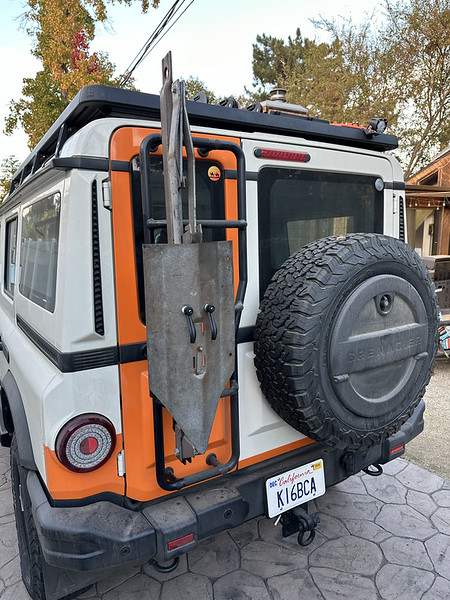

I carry a PullPal. Rarely used... great peace of mind when traveling solo as my wife and I tend to do.
Readjusted lower on the ladder since this photo was taken.
Wow that's big! I carry a big plastic box with a lid to carry my plastic gas cans and battery fuel pump on my roof. I could find a way to put on edge behind the box. Have you used it? Worried that I'd pull myself deeper in to the muck since I only have the front winch. Down side of getting a built in winch, can't move to rear.
You can use your front mounted winch to pull backwards...
There are smaller models... this is the 14k# Pullpal model. If I need it... I'll need it. Like my Highlift jack, a lot has gone wrong when I get to the point of needing my Pullpal. I've used my Highlift maybe a dozen times in 25years; I've used my Pullpal twice "for real" and of those times, once I probably could have found another way.
