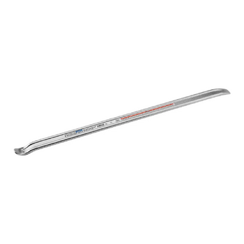

I ran into this issue after having my steel wheels powdercoated. Have a tool made out of the old L-shaped lug wrench - looks like a blunt chisel with somewhat-rounded, bent off to the side, blade. It goes through the holes in the steel wheel and the blade fits between the hub surface and the wheel.
By the way, a Harbor Freight tire iron works as well.

Too lazy to walk outside and take a pic - here's the concept:
That's the Harbor Freight tire iron:

,Aussie owners - Supercheap has 600mm tyre levers on special.
