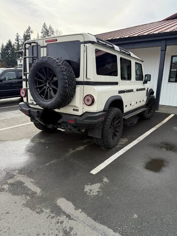

So couldn’t find much info on this and wanted to share. I have 20x9 wheels with 33.5x12.5 tires. Talk to a few companies and no one new for sure if there spare relocator would work.
David @Design Build Go said he Use the Agile off-road with the Agile spacer and it worked. I had heard it would work without. Tried it and was to close to wiped for my liking so added spacer…. Just thought I’d share for those looking in future.
