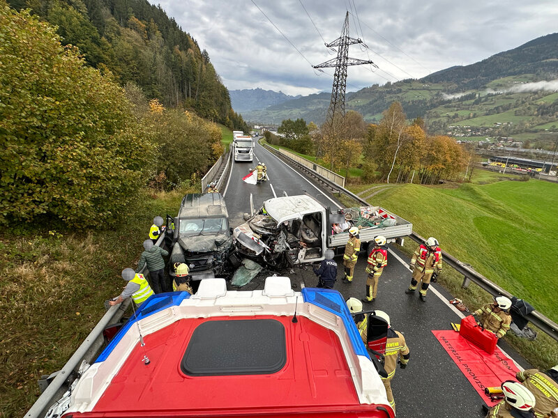

Looks like there was a crash in Germany this week with a Grenadier and a Van. I hope everyone is okay. Here is the link to the article and sounds like they had to use the jaws of life to get the person in the van out. The Grenadier looks like it survived and I hope it wasn't @emax As the color looks Donny Grey.
Looks like absolutely no deformity to the passenger compartment of the Grenadier, so that's a good sign
Holy moly.
It was in Austria in the backyards of Salzburg. Yes, the driver of the Daily (lveco) is not in good shape what I can read from the article. Still unclear the rationality behind the crash.
