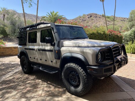

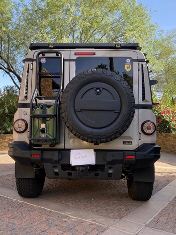

I mounted my DVA roof bars and beer can crusher. Next up is the Jerry can mounts and door carrier system. View attachment 7926988View attachment 7926990

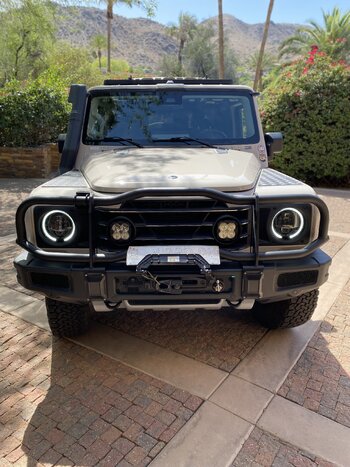

Thanks Brnadtnm! I've got four to mount. This helps plenty.Used Ext 2 switch, which runs passenger front exterior plug only (other 3 roof plugs are common to Exr3), wired lights in parallel to a DTP plug, drilled out light bases to accept t-slot bolts from underneath in the Leitner rails, mounted lights, plugged in, turned on switch. Voila’
My base mounts have a prior hole for extra bracing when they were on round bars-(HELLA recommends drilling the shell for the braces on rally cars, but the base brace is plenty). I used the extra bracing because it was already set up. I don’t know if just the Leitner bars would be enough off road . My HELLAS are cast aluminum shells and glass lenses so they weigh a ton. Something like an lp4 is way lighter.
