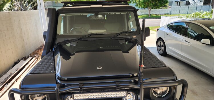

I put the fender guards on today. I was a bit nervous about drilling holes in my car, but very happy how they turned out. I also moved my solar panel to between the bars at the back of the roof. Seems to be much quieter.

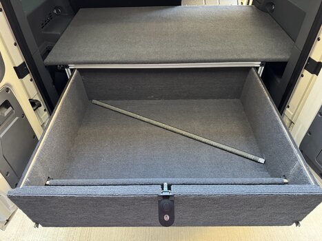

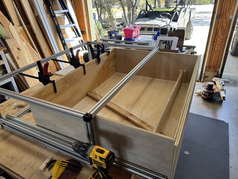

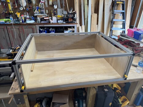

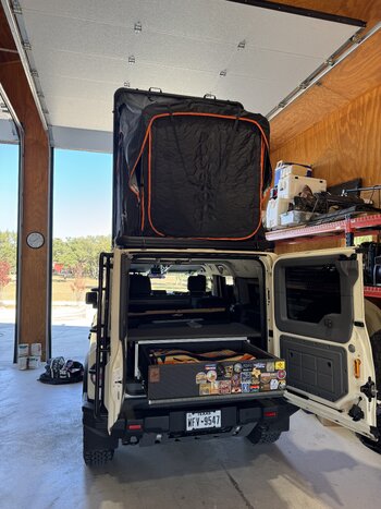

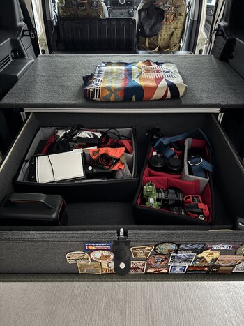

Howdy everyone!

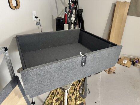

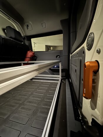

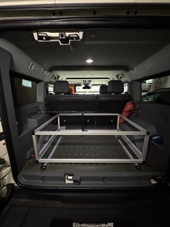

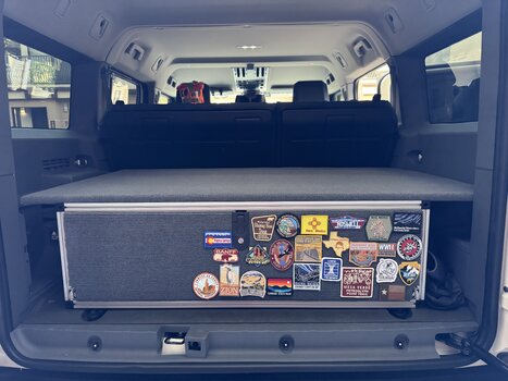

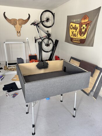

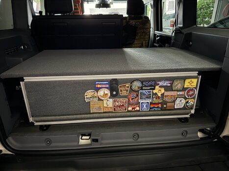

Thought I'd share the drawer system I made with my dad.
First time working with T-nutz (80/20) extrusions for the frame. Absolutely love this stuff, very sturdy and versatile!
Total drawer dimensions: 41.5" W X 12" H x 30" D
Drawer fits right in-between the lip of the floor liner on either side and the top / lid is above the 12V outlet.
Box is made with 1/2 ply wood and attached to the slides with T nuts (linked below).
We added a 4" tall divider that's removable, just for small pieces of gear / lens.

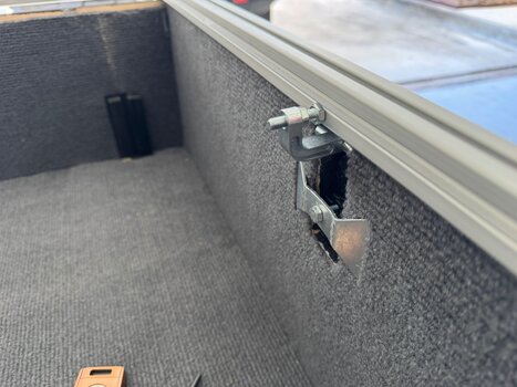

The drawer can be opened with one hand with the bar I installed across the two slide latches. Drilling through the galvanized steel was tricky, but once I finally had a hole through it I bolted on a piece of angled aluminum (1/8" thick). Wrapped the bar in about 80' of paracord too, helps add to the look and could be handy in a pinch!
It's been a fun project and already extremely useful. I took all my telescope gear and went out to the Texas hill country last weekend for some dark skies. Great way to carry / protect some pretty pricey gear!
Here are a few links to the things I can remember using:
Drawer Slides: Slides
Drawer Attachment: Drawer to Ineos brackets
Carpet: Carpet
Drawer Box T Nuts: T Nuts (Attaches box to slides)
Carpet Glue: Glue
Lock: Drawer Lock
Top Brackets: Brackets to attach drawer top
Here is my order list from Tnutz :
EX-1010 - 1" x 1" Smooth T-Slotted Aluminum Extrusion × 6
  • Length (in):
    28
  • Fractional length:
    0.000"
  • Machining for one end.: 1/4-20 x 1" deep tap $0.75
  • Machining for opposite end.: 1/4-20 x 1" deep tap $0.75
EX-1010 - 1" x 1" Smooth T-Slotted Aluminum Extrusion × 4
  • Length (in):
    10
    0.500" (1/2")
  • Length (in):
    39
    0.500" (1/2")
(HC-010-A) 10 Series Hidden Corner Connector (Inside to Inside) × 4
(TCS-010-B-BLACK) Square Tri-Corner - Black Anodized Aluminum w/hardware × 8
(DB-010-SS) Drop-In T-Nut w/spring-ball - STAINLESS - 1/4-20 × 20
Total price from T-nutz was about $320
