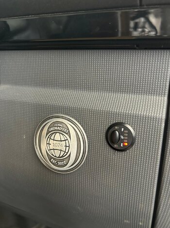

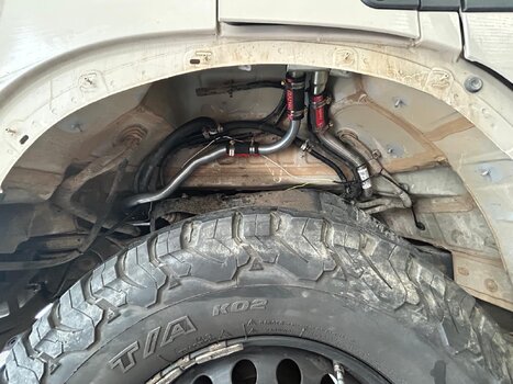

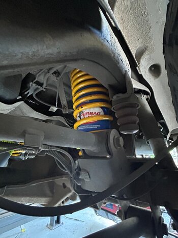

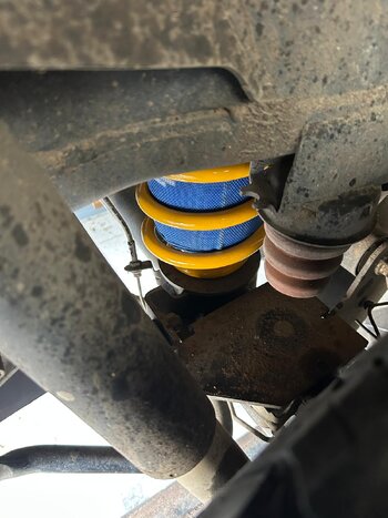

Liberty the Grenadier is with Compass in Bridgewater for fitting of auxiliary petrol tank. 90L from LRA Australia also fit Ineos OEM black marked springs and fit airbagman air bags in rear springs and modify exhaust to accommodate new tank. All going well so far. They seem like a very competent outfit with great communication 👌🏼

I'd like to hear your feedback on the LRA tank plus blacks plus airbags combo. I have the airbags going in on 14th August and will do the LRA tank later. I'm avoiding a spring change at this stage but I'm getting my rig plus camper weighed at trip weight in early September and that will determine what else I need to do.

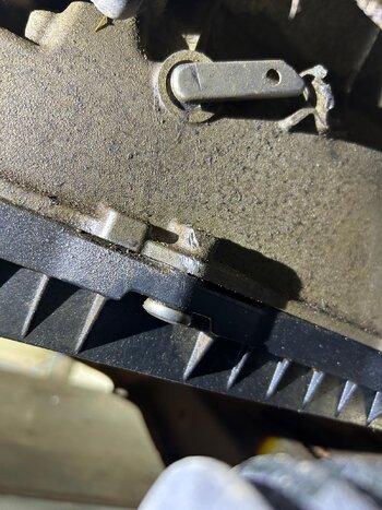

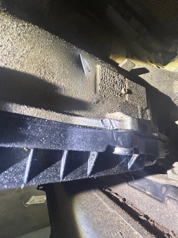

Before I took my Grenadier “Liberty” for the works to upgrade springs, fit auxiliary fuel tank and exhaust mods, I took all my underbody protection plates off as this was something I can do to save costs on the mods . I also wanted to get diff and transfer box oils changed as I had them changed in the early days at approx 8k miles in Botswana. All guards came off easily apart from the front diff guard, which had one rounded out Allen key bolt. This I easily sorted by drilling out the bolt then hammering a flat impact driver screwdriver bit into the drilled out hole then turning it out with a spanner. After taking the guards off I noticed an oil weep around the gearbox, damage to the transfer box Bowden cables and crushing to the heat shielding in that general area. All damage that had been caused when my prop shaft failed last August 2024. Whilst the vehicle was in for modification works at Compass in Bridgewater I asked them to investigate the leak and damage. It turns out there are are small cracks where the plastic gearbox pan is bolted to the aluminium casting of the gearbox. Caused by the flailing prop but not identified during the initial repairs. I had put underbody protection plates on the week after I got into back from repairs from prop shaft damage as I was concerned about the plastic gearbox pan. Anyway I relayed all my photo evidence of initial damage and observations to Ineos via Compass the dealer. I now have to have a complete new gearbox as can’t be repaired. This will be done under warranty as agreed by Ineos. Could be a while waiting for a new gearbox and getting it fitted though. Also noted was a leaking seal on one of the rear wheel hubs. Again being fixed under warranty along with new transfer box cables.
Well done Ineos for honouring my warranty. 👏🏼👏🏼👏🏼 A sigh of relief from me as this will be costly repair I guess..

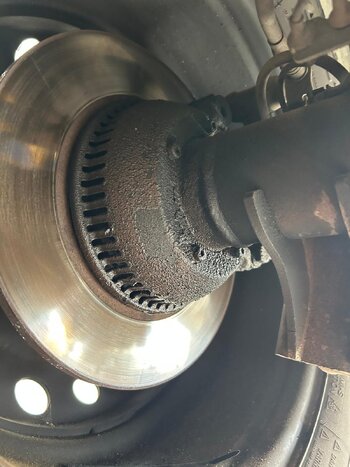

Photos attached show damage to original prop where it had been flailing around plus crack to gearbox case through the impact plus the hub seal leak and IMG_3738.jpegIMG_3902.jpeg149857a.jpeg149857f.jpeghub leak.jpegthe guards I fitted to mitigate damage in the future.
Now unfortunately the long wait to get it fixed. Compass are doing all they can to expedite the repairs and have been thorough and communicative during the process, so a call out to them and everyone at Ineos who has been dealing with my case. Im getting to be well known at Ineos I guess with the various issues I’ve had 😂😂
