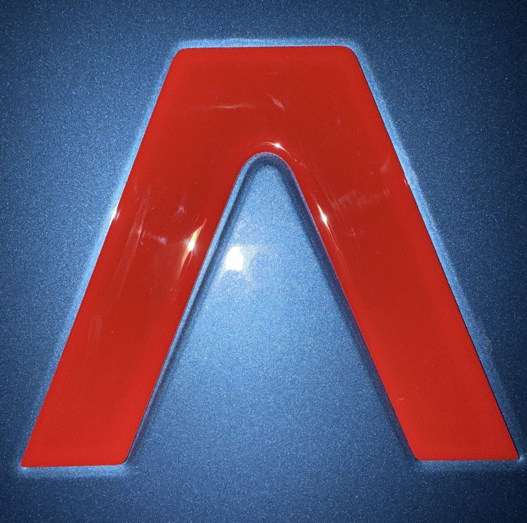

Received some stuff from Germany. I had forgotten I ordered all of this when I ordered the Carbon fiber grill (I expect the grill tomorrow.)
This was very easy to put on, I wiped down a alcohol prep pad for adhesion. This is very 3D sticks out, The lambda on the back ladder should reflect nicely. The black stainless is a peel and stick, so glad no transfer required.

This was very easy to put on, I wiped down an alcohol prep pad for adhesion. This is very 3D sticks out, The lambda on the back ladder should reflect nicely. The black stainless is a peel and stick, so glad no transfer
