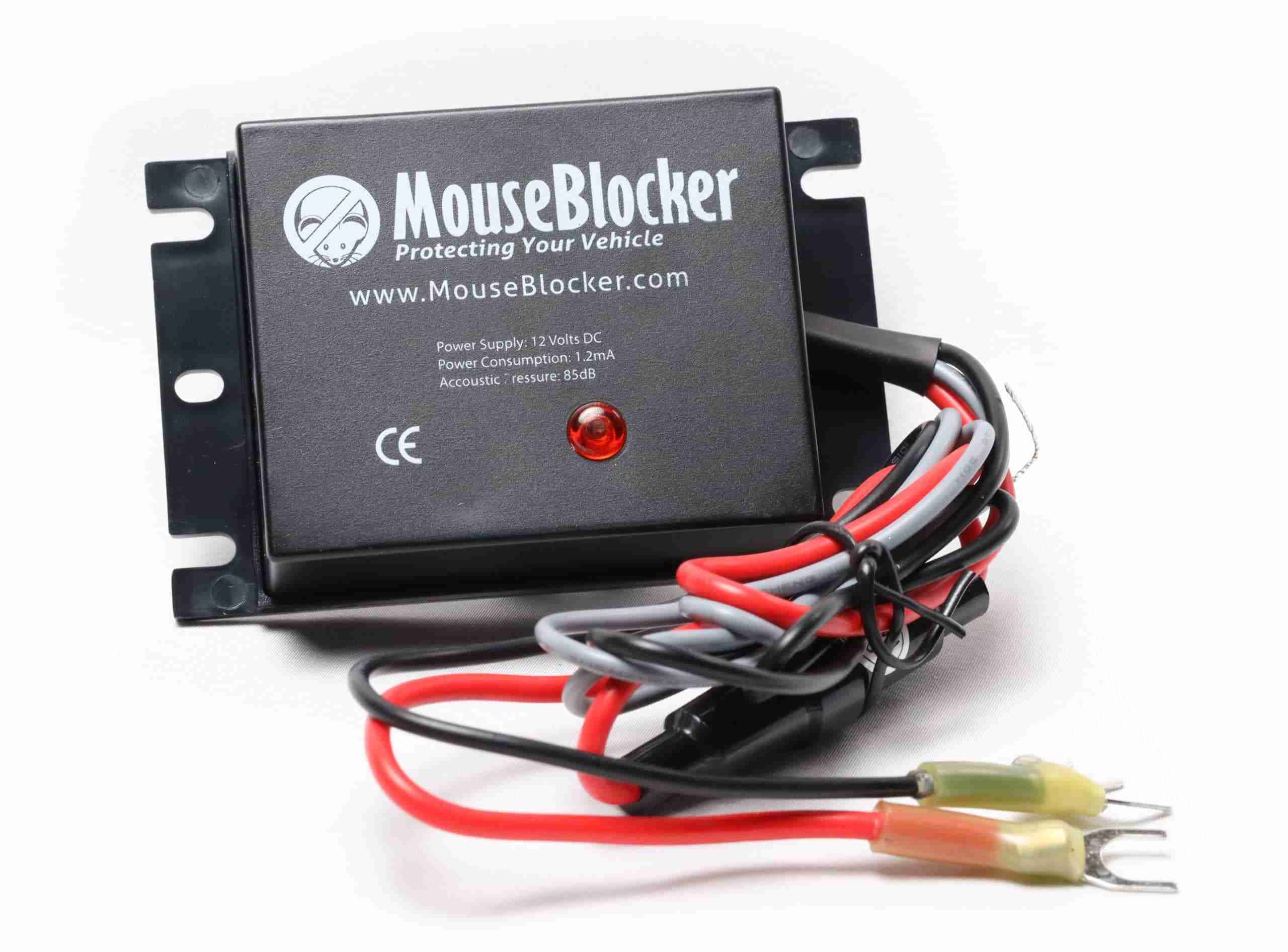

Look for something like this https://mouseblocker.com/
I've looked at something similar but we have cats 🐈 and it falls within their hearing range. If they spent their time mousing 🐁 I wouldn't have a rodent problem. Their idea of mousing is bring them into the house 🏠 to play with, then watch the humans try to catch them.
