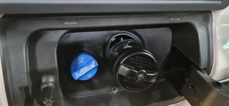

I crawled around under to have a look. I was mistaken with the filler tube up against the shock. It is not up against the shock or spring. It looks okay but just a little, I dunno, strained. I can see the bulge in the plastic wheel arch that I'm guessing is the filler tube hard up against it. The filler cap doesn't come out in the same place as the original, leaving a gap in the rubber. It all seems to work so I'll probably just leave it. I've got two weeks left before movers clear out our flat and we head out on this big lap of Australia.
They have used the Brown Davis filler with yours. The guys who installed mine said they use the Ineos one because the Brown Davis was a bit bulky and the angles of the tubing didn’t quite fit. The downside was the tank being slow to fill but that was rectified with a second breather.
That's the kind of installation I was hoping for. You know, someone who actually thought about what they were doing and didn't just slap it together. I wouldn't take my Grenadier back to the place that did the work and wouldn't recommend them. On the one hand I can kind of forgive the exhaust hard up against the shock. They weren't an exhaust shop and didn't have the equipment to do a simple expansion operation on the tube. They would have had to take the entire tank out again just to cut the pipe shorter to make it fit right and no doubt that would have cut the profit on the job. If it was me, I would have taken the tank back out or taken the exhaust tube to an exhaust shop. The filler tube just annoys me now every time I look at it. I'll take it apart and do the job right when we're back in the UK.
