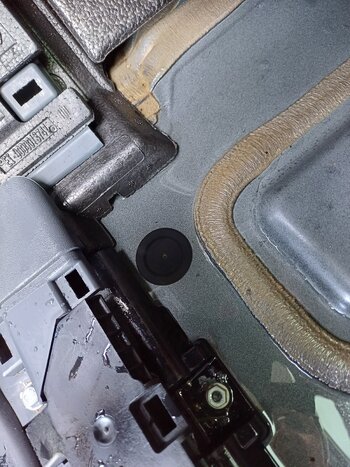

Have you got safari roof? Next check inner door seal isn't channeling water in. Remove the panel shown below and check for water in the " cup" in the plastic moulding. That usually points to safari roof. Next is there a cable grommet in the bulk head on the drivers side? Mine on the passenger side was passing water.

Thanks Eric
I have had that plastic cover off on numerous occasions and not been aware of any dampness. I will follow you tips before moving on to other areas of concern. I do have the sunroofs and in the most torrential rain I have remained dry. At least above the floor matts.

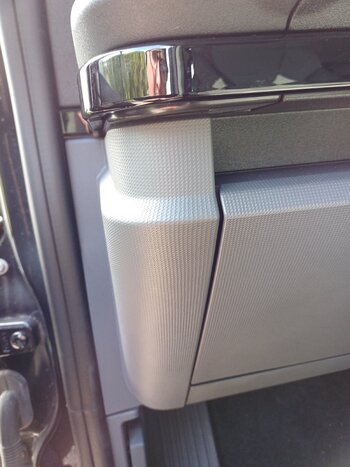

Mine was dry above the floor mats, until the depth of water underneath got deep enough to manifest on top. The water tracks down the A frame and appear at the bottom.

Probably you checked this already, but there are similar plugs or grommets under the back seat behind the battery. Check for missing ones. Also check the tightness of the removable plugs.
