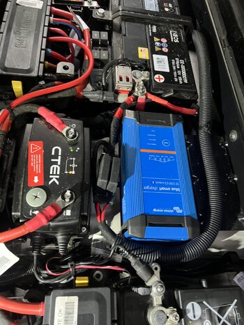

If it helps ease your mind. My Grenadier is on charge via a permanently mounted Victron 30a charger and I’m away working. No worries. 😉 IMG_4379.jpeg
Cheers logsplitter. I have been reassured from your comments tbh. I was happy to do it, but wanted to make sure that there was no specific reason why the grenny shouldn’t be left like that.
