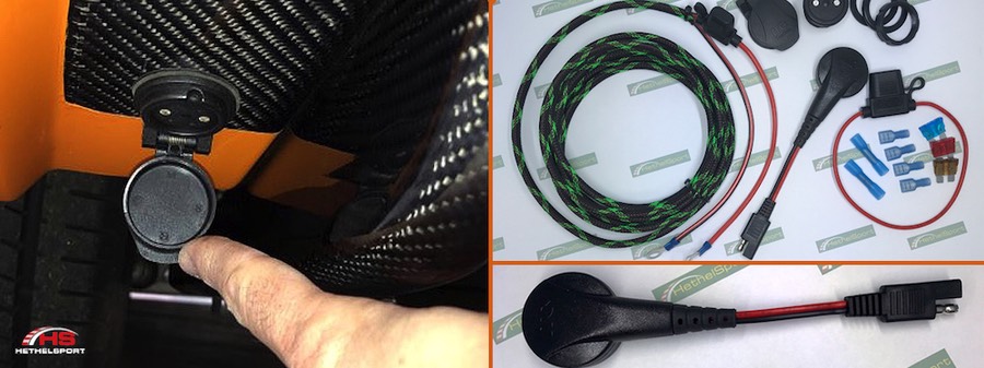

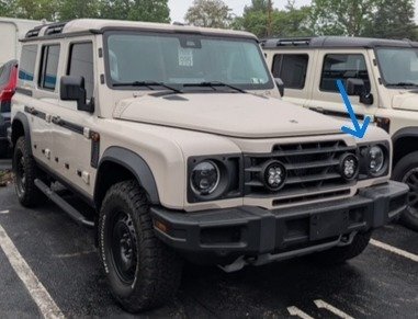

I posted this elsewhere but I had this kit installed by RDS, they located the hookup in the black plastic headlamp bezel on the driver side. Sorry no photos can post some when I get my truck back again in a few weeks. They ran the wiring to the battery as they'd had problems with vehicles that they had charged via jump points under hood. This will work with any CTEK charger and provides a quick magnet hookup.

On all of my BMWs with battery in trunk and jump points under the hood I've always just attached the battery tender to the jump points under the hood. I had dealer install the hookup and they went straight to the battery as they'd had trouble with cars in their showroom not charging well from under hood hookup. I don't have any info other than that so unsure if it's a Grenadier thing, a dual battery thing, or something specific with their charger. Since I wanted them to deal with any issues post-install I let them do what they wanted. Sorry not the best photo but you can see where they mounted the hookup point, very happy with the install.
