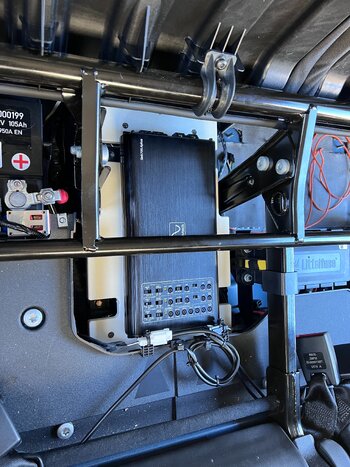

Sorry did not take any before/after photos of the speaker pods before grinding. I just held my new speaker in place and drew on the area that was interfering with the speaker so it could fit flush. You can also use a cardboard template sized to the speaker to figure out where to trim.
I did not line the inside of the door with sound deadening material. I was not up for full disassembly and wanted to see how much noise was reduce by just doing the inside of the door card. My conclusion, the door card is more than enough, dont over think it.
As for the amp rack, I used this from Agile Offroad Agile Offroad Amp rack fit perfect and works awesome.
With respect to the factory speaker connectors, there are 2 wires soldered to the OEM speaker then a quick connect. I simply disconnected the quick connect and then moved with wires to my new speakers. Now I can plug my new speakers into the factory harness in the door. I bought some 19mm wide Tesa tape to wrap all the wires yielding no rattles and looks complete.
Full disclosure on how I learned to disassemble, head unit connections etc. came from searching this forum and reaching out to the CEO of Car & Audio Bjorn Student. His firm sells the complete turn key kit for upgrading amp/dsp, sub and front speakers. He was very kind enough to share his install manual so that I could reference.

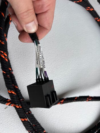

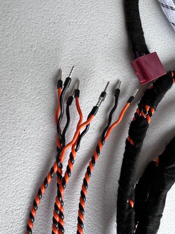

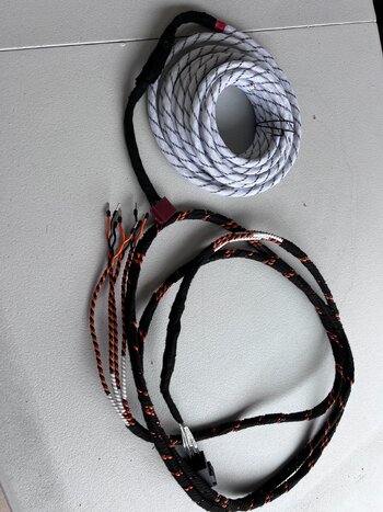

Phase 3: 4 Channel Amp and wiring harness
Spent last night running the wiring harness to the head unit. It was a tight fit to get the brown connector removed from the unit but it got done! Below are the wiring looms for the amp output and the speaker level inputs from the head unit. Happy to report that the signals are clean, wiring went in easy and overall it looks professional. Having 125 watts of power to high end speakers is a game changer. I have begun dialing in the HP crossover, gain and trim levels. The sound stage is more than I could have hoped for. Would 2 way component speakers have better sound stage? The answer is yes, but for me that $800 additional premium is not worth it at this time.
I will post some shots off the wiring and how I routed it.

Great sharing the Agile mount, was definitely not looking forward to fabbing something myself. Good to hear its simple to just desolder the factory harnesses, for some reason I imagined it more complicated.
Couple of follow up questions:
is your amp in the middle? Looks like it from the pic, I will need to mount in the middle, as I have the dual batteries.
When you ran the wiring harness from the brown connector back to the amp, what type of connector is it? from what I've been able to figure out its just a standard ISO harness, like this https://www.amazon.com/Connector-Ha...ofessional/dp/B0C5QGL8KQ?tag=globalgrena0b-20, but would appreciate a confirmation to save me the order/return circle.
What is the black cable with the labeled speakers for? Is that the return from the amp to the original brown connector you had removed from the head unit that runs to the speakers themselves?

The wiring is pretty straight forward:
  1. disconnect battery and let sit 30 minutes before doing any electrical work
  2. Remove floor trays for drivers and rear passenger floors
  3. Remove door sills
  4. Remove lower plastic off of B Pillar
  5. Remove hood lever and plastic around it
  6. Remove side and lower dash panels under steering wheel
  7. Remove "brown" ISO 8 pin socket from back of amp unit. Looking at the unit, this is located on the left side rear
  8. Plug in the new brown ISO 8 pin from the extended harness. You have now created an extension to feed the amp with speaker level source input
  9. Connect the black connector to the factory brown ISO 8 pin located under the dash. This is now the feed from amp.
Not really hard to do and not much exploration either. Post any questions!
