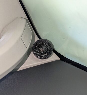

I have used the pods in the upright position. I mounted them at the base of each A pillar cover and pointed them across the cabin so the left side tweeter (RHD pic) is facing the right front seat and the right side tweeter is facing the left front seat. That accords with the Hertz information for location and orientation.
It's quite an aftermarket look but it was the least impactful way of fitting them given I had no idea of how they would sound. I used two small screws to mount each pod versus cutting a big hole to surface mount them. If I didn't like the results it would be easier to hide small screw holes. I might surface mount them next time I'm working in that area.

I mis judged clearance of the windshield. My first attempt at positioning the passenger side pod resulted in the pod touching the windshield, so in had to file it down 😡
