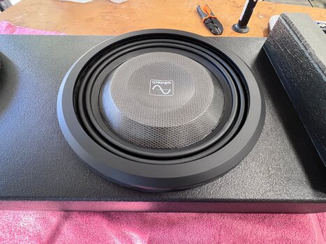

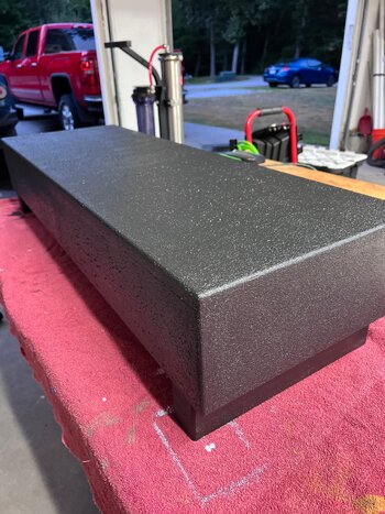

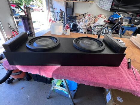

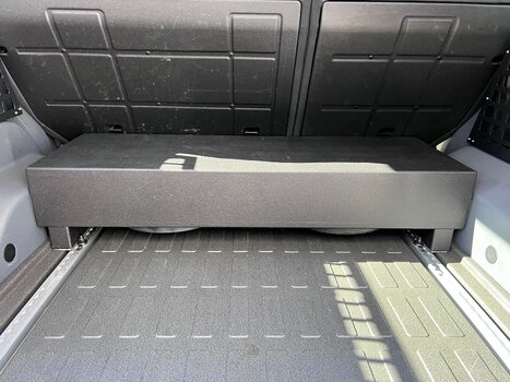

I started with Bass as I did not purchased the factory JBL option. Instead I went with a proper brand and landed on Wavtech. This is a US domestic company that has a lot going for it. They are pushing the envelope of sound innovation, quality build and actual customer service you can call and speak to someone! I will admit my Bass build might be overkill for some, but you only live once!! Went with 2-12" 2 ohm low profile subwoofers, the Wavtech 1500.1 mono block amp and custom box. The box is made from baltic birch 3/4" with one open chamber yielding 1.2 cubic foot of place. It was then painted with speaker box painted called Duratex. The amp mounts under the back passenger seat and connect directly into the "factory sub wire hookups". One of the biggest draws to Wavtech was its excellent native features for connecting to an OEM system. No need to a LOC to convert, amp has it built in! The amp rack is built out of HDPE (1/2" starboard) which makes shaping and heat setting threaded inserts a breeze. Last item is the remote gain knob that I mounted temporarily next to the handbrake. A bit of tuning, now I can hit serious bass in sealed box that is tight and smooth!
*Sub box dimensions are 39" wide x 6" high and 13" deep. The attached photos show down firing with legs. I have since then removed the legs and now it fires up with much better response.
* The sub box is held in place with 1" L track bolts I picked up from Amazon and some L brackets. If I need to take it out, it 4 screws and done!
* For the amp turn on lead, I tapped into the backseat fuse panel and used the switched circuit that controls power to the headlight leveling option. I can post a photo to help others.
Gear:
Wavtech ThinPro 12"
Wavtech 1500.1 amp

  • If space were more of a concern I would have stepped it down to 1 Wavtech 10" sub and Wavtech 500 watt amp. My original plan was to put a single 10" under each front seat, fiberglass enclosures etc. Its a great option but I need that space for a compressor and some other junk.
I want to recognize Matt at Watech support of answering all of my questions, checking my math and helping me select my gear! Can't recommend this company enough!
This first phase is done! If you just want to add Bass to your Grenadier here is how I did it without breaking the bank, getting top of line gear and had a lot of fun in the process. If you have any questions, please reach out to me!

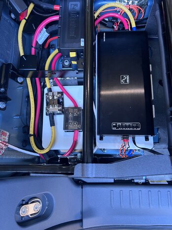

Phase 3: 4 Channel Amp and wiring harness
Spent last night running the wiring harness to the head unit. It was a tight fit to get the brown connector removed from the unit but it got done! Below are the wiring looms for the amp output and the speaker level inputs from the head unit. Happy to report that the signals are clean, wiring went in easy and overall it looks professional. Having 125 watts of power to high end speakers is a game changer. I have begun dialing in the HP crossover, gain and trim levels. The sound stage is more than I could have hoped for. Would 2 way component speakers have better sound stage? The answer is yes, but for me that $800 additional premium is not worth it at this time.
I will post some shots off the wiring and how I routed it.

Couple of follow up questions:
is your amp in the middle? Looks like it from the pic, I will need to mount in the middle, as I have the dual batteries.
When you ran the wiring harness from the brown connector back to the amp, what type of connector is it? from what I've been able to figure out its just a standard ISO harness, like this https://www.amazon.com/Connector-Ha...ofessional/dp/B0C5QGL8KQ?tag=globalgrena0b-20, but would appreciate a confirmation to save me the order/return circle.
What is the black cable with the labeled speakers for? Is that the return from the amp to the original brown connector you had removed from the head unit that runs to the speakers themselves?
Thanks!

The wiring is pretty straight forward:
  1. disconnect battery and let sit 30 minutes before doing any electrical work
  2. Remove floor trays for drivers and rear passenger floors
  3. Remove door sills
  4. Remove lower plastic off of B Pillar
  5. Remove hood lever and plastic around it
  6. Remove side and lower dash panels under steering wheel
  7. Remove "brown" ISO 8 pin socket from back of amp unit. Looking at the unit, this is located on the left side rear
  8. Plug in the new brown ISO 8 pin from the extended harness. You have now created an extension to feed the amp with speaker level source input
  9. Connect the black connector to the factory brown ISO 8 pin located under the dash. This is now the feed from amp.
Not really hard to do and not much exploration either. Post any questions!

Hello Derek,
To answer your questions:
  • The agile offroad mount is place in the center of the mechanical area and straddles over the transmission tunnel. As a by product it provides some extra protection to the emergency brake cables. If you go to Agile's website you can see a clear photo of it mounted. I did add a 1/2" piece of HDPE board also known as Starboard. It cuts and shapes with standard woodworking tools. I used this so that I could use threaded inserts rather than self tapping screws. Easier to remove and look for professional.
  • The amazon wiring harness you found is spot on! Wish I found that one. You will only need the one with the brown ends as this will be used for the speaker wires. The other set is used for power/ground etc. Most new cars is an ISO standard which makes this whole process simple to wire and attach. One end will be used to plug into the back of the factory head unit located under the steering wheel. This will be your head unit source also known as speaker level inputs. The other end will plug into the harness under the dash and will carry the amplified signal from the output of the amp.
  • The black cable in my photos is for the amplified output from my amp. I could not find a male 8 Pin iso connector so I used a 16 pin but only used one side for the speakers.
With respect to the wire I used. For the amplified signal to the speakers I used 16 awg Belden 9497 wire. This is twisted, tinned wire that is very high grade. Complete overkill, I used it because it was left over from another project. This wire is typically used inside very high end speaker cabinets.
For the factory signal output I used a loomed, twisted and shielded bundle from Amazon. Speaker wire bundle. This was a much better option and saved me a lot of time. If I were to do this project again, I would get 2 of these bundles; 1 for the source from the headunit and another one to provide the amplified signal to the speakers. It is 18 awg but considering the short lengths in the Grenadier it is more than sufficient for the 100 watts per channel. I did run this by support at Wavtech. The tight nylon loom on this wire make pulling the wires in the sills super smooth.
Let me know if you have any questions or if you are interested in me making you wiring harness.

Question for you - did you run a 12v remote turn on for your amp? Tried to search the thread but didnt come up with anything. There's gotta be a 12v wire thats only hot on start somewhere under that rear seat and hoping you can save me from searching all over for it 🤞
Hi Derek,
For my amps I used the headlight leveling circuit with a piggyback fuse. This is the under seat fuse panel, Location FI39. This has worked out very well for my 2 amps. Let me know if you want a photo.
-E
