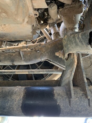

Looks like I have a similar issue that has just manifested.
Sitting at an intersection only 30min ago and smoke starts to come from the engine bay. Pulled over and instantly checked the oil level, all good there.
Crawled under the vehicle and it is very apparent. Dripping oil from the turbo. Same engine, B57. 30000km on the clock.
To say I’m annoyed would be an understatement.
