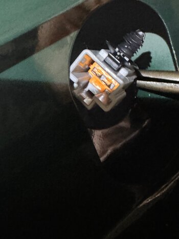

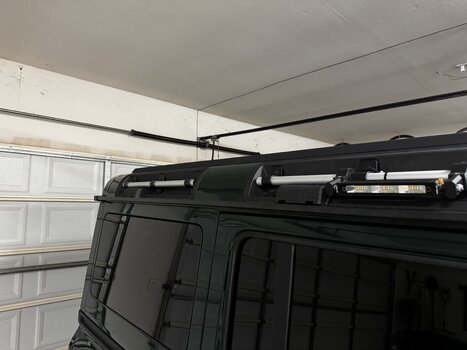

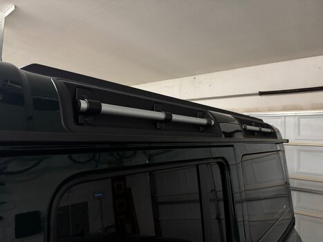

Starting to map out lighting and thought I was going crazy. My 25 fieldmaster with the extra aux switches is missing the dtp plugs/protective boxes on the driver side roof. They are on the passenger side front and rear, missing entirely on the driver side.
I pulled the grab bar panels and a strange connector is seemingly ready for the boxes front and rear, but were never finished out.
Dealer to rectify?

Yes, that Deutsch connector with the fir tree plug gets mounted to the inside of the roof support structure. Then a DTP harness is routed to the exterior roof box. My roof outlets were all 100% factory wired and complete. I deleted the front/left connector as that is now where my solar PV cables enter.
Spoke to the dealer tech. He’s never seen this and wants to bring it in to figure out what they need to order to fix it….
