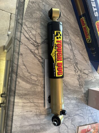

Took a while but received yesterday. Will wait until new front prop is fitted before fitting the TD.

Yes that's what mine took - plus £60 odd in taxes and UPS clearance fee. Have set to no.4 based on others experience and look forward to having a go.
Setting 5 works best for me on the Tough Dog steering damper, there is a big difference between setting 4 and 5, about the equivalent of setting 2 to 4, from my testing setting 6 is similar to factory.
Thank you. Will try them both and compare. 👍

Did the Tough Dog Steering Damper fit straight out of the box, plug and play or did you need any fabrication to get it to work?
Play around with the adjustment to suit the conditions, too soft and you'll have the death wobbles, I found the best way to gauge this is if your steering wheel does a slight "stick shake" like in aeroplanes on uneven surfaces tighten it up a little.
Play around with the adjustment to suit the conditions, too soft and you'll have the death wobbles, I found the best wat to gauge this is if your steering wheel does a slight "stick shake" like in aeroplanes on uneven surfaces tighten it up a little.
