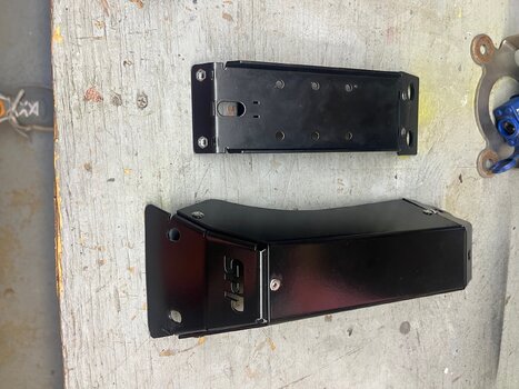

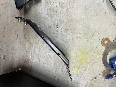

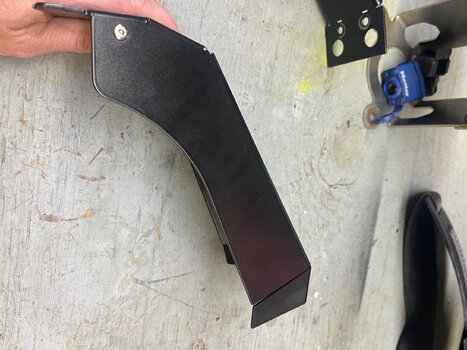

Update and a plea for help. Still no brackets, and have had a bit of trouble getting in touch with Rene at SPP. I am hoping he is just on vacation, but I am starting to lose faith in this solution.
Unfortunately, I am $2500 in on a light bar I cannot mount and wasted about 6 months of time.
I could take the light out of the housing, but it is riveted in pretty well. Looks like RRE is now making one in the US.
Can anyone recommend a fabricator who can make slightly (1 - 1.25") taller brackets ? Need a steeper angle to accommodate the little shark fin antenna on the US model Grenadier.
Getting a little desperate to make this work and not look janky...

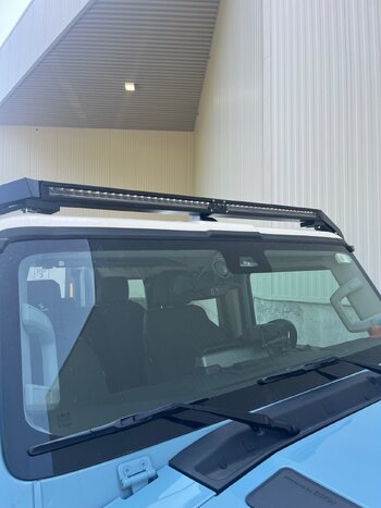

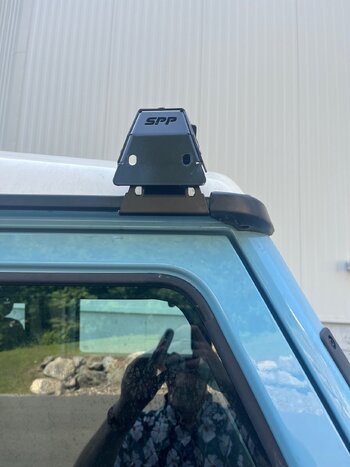

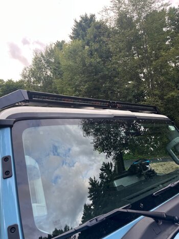

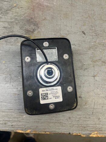

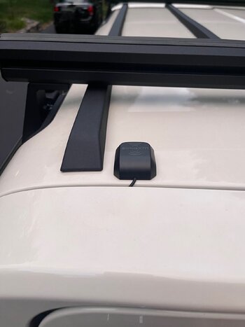

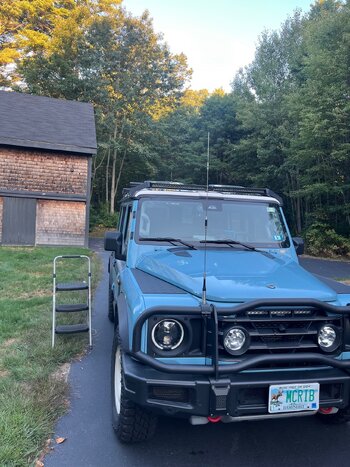

OK - I have a resolution. I was unable to connect with Rene at SPP over the last month, but had an epiphany after staring at the roof for months.
I checked with the guys at Ko Ineos, and they confirmed that the sharkfin was only for satellite radio. GPS is in dash, and AM/FM is in D pillar. The sharkfin is just held in by one nut, accessible beneath the overhead load panel. Replaced the antenna with a grommet and applied silicon. Ran the sat antenna from the existing feed between the safari windows to the rear using an off the shelf adapter. Plugged it in to the deutsch plug on the grab bar.
Now the light bar fits as intended, riding about 1/4" above where the sharkfin was.
The punchline to all this - the SPP GorillaBeam looks great, rides super low, and works fantastic. However for the US models, be prepared to relocate the sharkfin. Not super expensive or hard, and I imagine any car audio installer can remove the sharkfin and install a throwaway/B stock SiriusXM one.
I feel silly I did not think of this long before.
