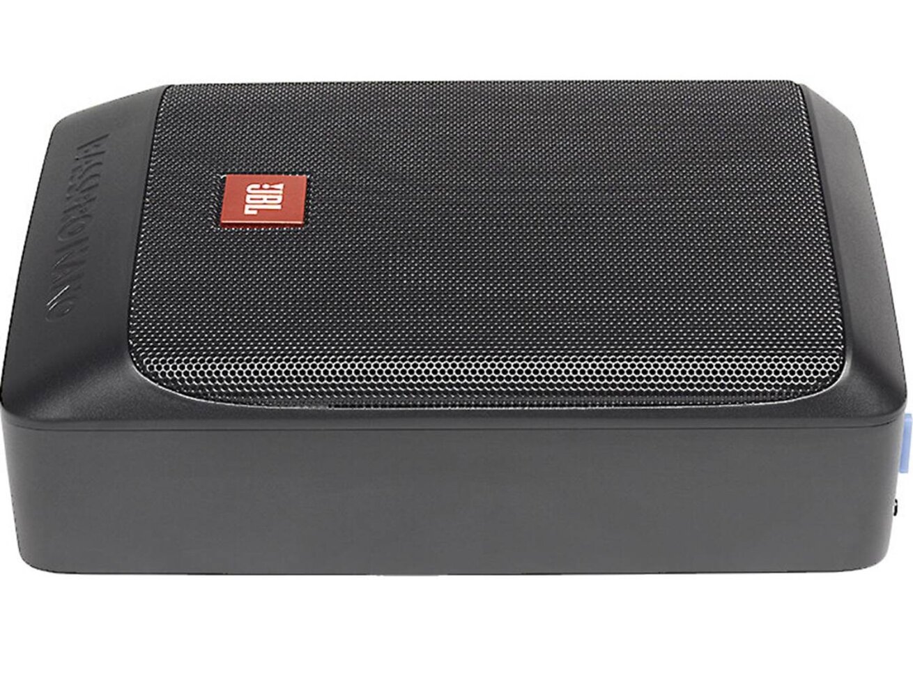

Well said, I had the same rational in adding it to my order and now feel the same as you....disappointed. The actual subwoofer is average but it's a joke for $700, and the installation package is meh. I had also assumed/hoped it would be multi-channel to drive the other speakers.
Is that sub lashed down in any way, or just sorta chucked in there?
Hey Krabby!
So Ineos mounted this speaker close to a 90 degree angle, (facing forward/upward towards the front) on a simple "L" shaped bracket that can be removed in maybe a few minute. There's still loads of room under the seat (see pics) for a larger speaker or other options. This subwoofer is about the size of a large Dictionary.
If You look at the original photo that's a bit blurry, you will notice the side with the the variable bass frequency, phase switch, & low pass cross over controllers.
because of The way the subwoofer is mounted by Ineos,
"YOU CAN NOT ADJUST OR ACCESS THESE CONTROLLERS UNLESS YOU REMOVE THE ENTIRE UNIT"
To understand this better, I attached a stock photo of these controls on the subwoofer you would use to "dial in" the best bass sound the owner prefers: Again, there Is not enough space to access this as it sits now.
Also, anybody could wire this up as it comes with the wiring harness & labeled wiring instructions right outa the box.
Here are the specs you get for $700.00 premium sound
  • 6"x8" shallow-profile woofer
  • built-in amplifier: 100 watts RMS (200 watts peak)
  • 10-gauge wiring kit
  • controls:
    • low-pass crossover variable from 50-150 Hz at 12 dB per octave
    • variable bass boost (0 to +12 dB at 50 Hz)
    • phase switch (selectable 0 or 180 degrees)
    • wired remote volume control
I'm also guessing Ineos purchased these little guys in bulk & paid much less than the $229.00 retail price....

Damn I ordered it too. They couldn't even use the line ins? They used the speaker level inputs. Sad.
There's nothing on the infotainment to produce line level outputs unfortunately

Hi Roach, did you see post #25 above. It shows the sub-woofer and there are adjustments on it, however as @RunBikeDive mentions, you would have to first remove it from under the rear seat to get at the controls. Perhaps a better way to go is to simply buy the unit yourself and install it under the front seat. A bit more work, however now gives you the flexibility of ordering a second battery and then getting a sub-woofer. I ordered the second battery by getting a Trialmaster and am opting to adding a sub-woofer after I take delivery in April 2024. DaBull
