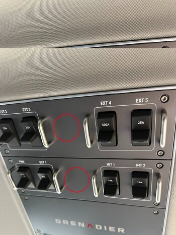

If the car have the second Auxilary row we place the DRC controller right in the middle of them. Works fine. We will add this to the manual soon.

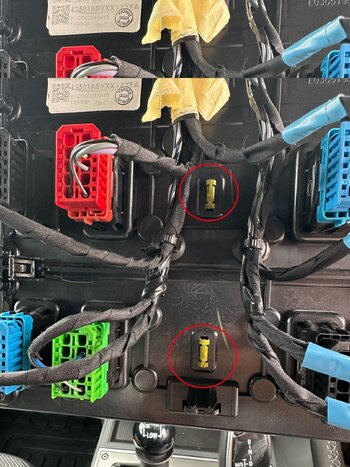

Thanks Bjorn. I'm just unsure how this would work given the yellow bits right behind the location between the switches. I was also unable to remove just the cover after removing the screws as it seems to still be attached in the middle somewhere. I didn't want to pull too hard and break the panel. See the attached pictures with the possible location for the DRC remote control circled from the front and from the back of the switch panel. If you have pictures of an installed remote control knob for an auxiliary switch panel that would be greatly appreciated.

You can detach the yellow part with a small slotted screwdriver. It´s not a big thing.
We have the next Grenadier middle of the next week in our shop. I will make some pictures and post them here.

Thanks Björn, much appreciated.
