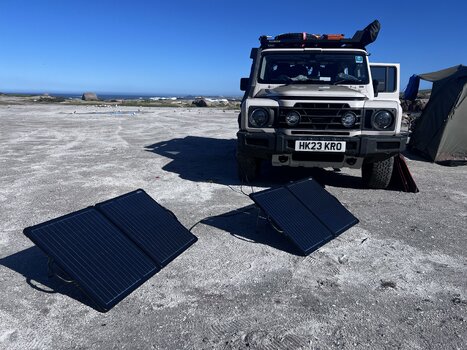

When I camp I have 2 x 100watt suitcase style solar panels. These have inbuilt mppt controllers and I charge the Grenadier via the jump start post under the bonnet. This seems to charge both batteries and I have an ARB 47l fridge running constantly. The mppt controllers regularly indicate that the battery is at the float stage so all seems fine. When at powered campsites I plug into the mains and trickle charge the batteries with a Victron smart charger.
Hope this helps.

View attachment 7899902View attachment 7899903View attachment 7899904

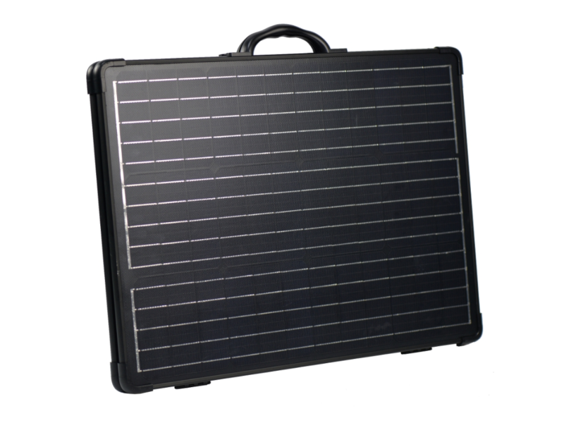

I have a "loose" MPPT that I bought many years ago to use with a previous solar panel on my old Defender. I was thinking of using that as a backup, in case I really needed to charge my primary battery, but was told it was not a good idea since I already have a Victron MPPT wired to the 2nd battery.

This is what I am after, just thinking if I ‘d rather hard mount a single panel on my roof rack.
I prefer the suitcase style as I can move around to best catch the suns rays. Also they are very tough. My wife ran over one of them and although dented and misshapen still works fine 😳

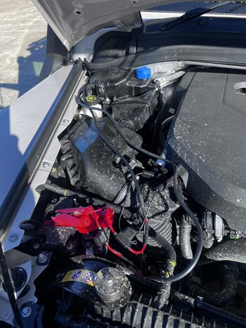

My system was working well in December in the Kgalagadi. My Engel fridge is small and doesn't use much power. This upcoming trip I need to run my camping lights from my vehicle and they really eat up battery power. Our game drives will also not be as far as in the Kgalagadi, so batteries won't have as much time to charge. So I'm looking for a quick fix option to charge my main battery if needed. Where do you connect your negative clamp to? I see it disappearing under the engine cover on your photo. I haven't had much success connecting anywhere else than on that lifting eyelet under the engine cover, but it is a pain in the ass to always have to take that engine cover off, plus it gets really hot.
I do connect to the lifting eye as mine is easily accessible in the petrol version. Adjacent to the live post under the bonnet is a small stud that some people use for the same purpose. I think it’s the one I’ve indicated on the attached photo. Others may verify for me.

@Dawid Potgieter you have the Diesel or Petrol Version? Logsplitter and I have the Petrol version and the lifting eyelet is easy access without disassembling the engine cover. I use a loose Victron MPPT too, with mobile 240W panel, less than 1 hour charging both batteries from 60%-100%. With the mobile panel you can follow the sun easy.

Thanks. I'll give that a try. Mine is a diesel, so that lifting eye is well hidden.
@Dawid Potgieter you have the Diesel or Petrol Version? Logsplitter and I have the Petrol version and the lifting eyelet is easy access without disassembling the engine cover. I use a loose Victron MPPT too, with mobile 240W panel, less than 1 hour charging both batteries from 60%-100%. With the mobile panel you can follow the sun easy.View attachment 7899923
Diesel. Lifting eye is far underneath engine cover.
Check the bolt i indicated for an earthing point. If you have one try a multimeter test to measure resistance of the earth point you choose.
