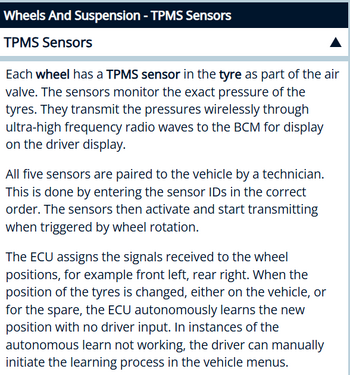

Found this the the Ineos workshop manual. Maybe something changed in the specifications since this was written, but at one time they thought the TPMS system would relearn automatically. BTW, this is the only thing I could get their website to download...impossibly, unusably, slow.
