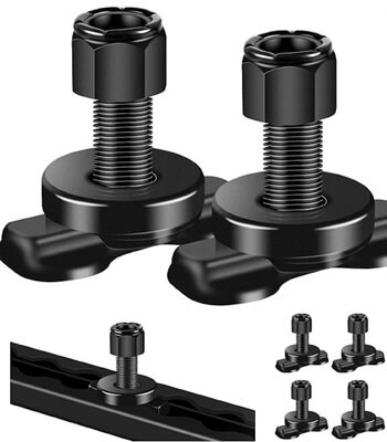

This thread lists some of the L Track tie downs available. Various L Track tie downs being discussed here. Like this one (that may work):
Do let us know what works, including the shovel chosen or used.

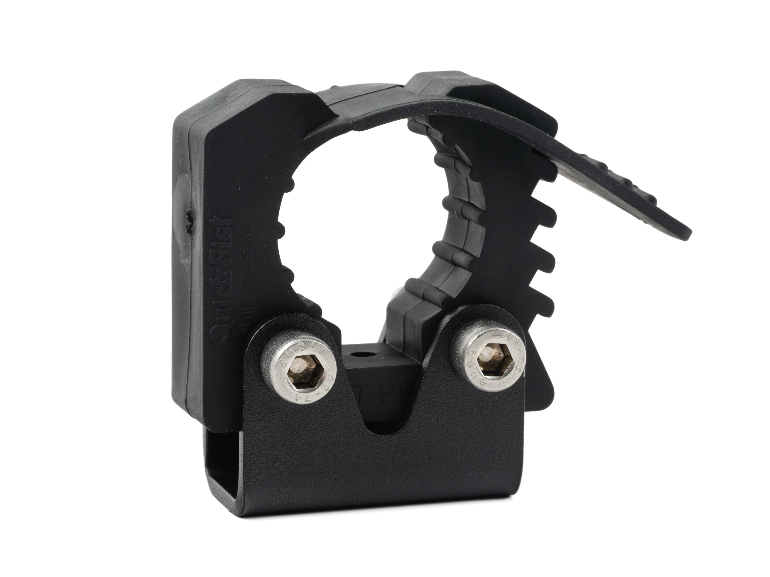

It was a fail from me. I ordered quick fists and tried a few combinations, but in the end the contour of the car didn’t allow enough room for me to be comfortable the shovel wouldn’t make contact with the paint. Interested to see if others find a better as I would like to make use of those tracks with something practical! So far they’ve been ornamental.

I made the brackets shown in the pic below and used a Quick Fist to attach a shovel made by Bully Tools (#92712, available on Amazon). Very happy with this setup. Super quick to grab the shovel when needed, and the knobs allow quick removal of the brackets when I don't need them.
The ones shown are unpainted prototypes but the final powder coated brackets are ready to be ordered in a batch if there is sufficient interest. This is a multi-purpose bracket that has a few different uses (shovel mount, griddle mount, or GoPro mount). I plan to start a new thread about this in the Skunkworks forum soon.

Thanks, can I suggest the shovel's blade is always pointed rearwards.
That's a pretty slick mount!
Yes, I think so too. And I doubt whether the direction of the shovel really makes a difference in terms of possible injuries. You either have a gaping, clean slash wound or a broken piece of rubble. Even the German thoroughness with the edge protection doesn't help, as shown in the photo above. The vehicle was at an Ineos event in Böblingen a few weeks ago.

There's a "riser" product offered from Z1 Off-road that may address this. When I get around to mounting the Sidekicks from Leitner I am planning on trying to fit Quick Fists to the load-bar mounts to see if I can put a shovel up there - and was thinking I might need these risers.
