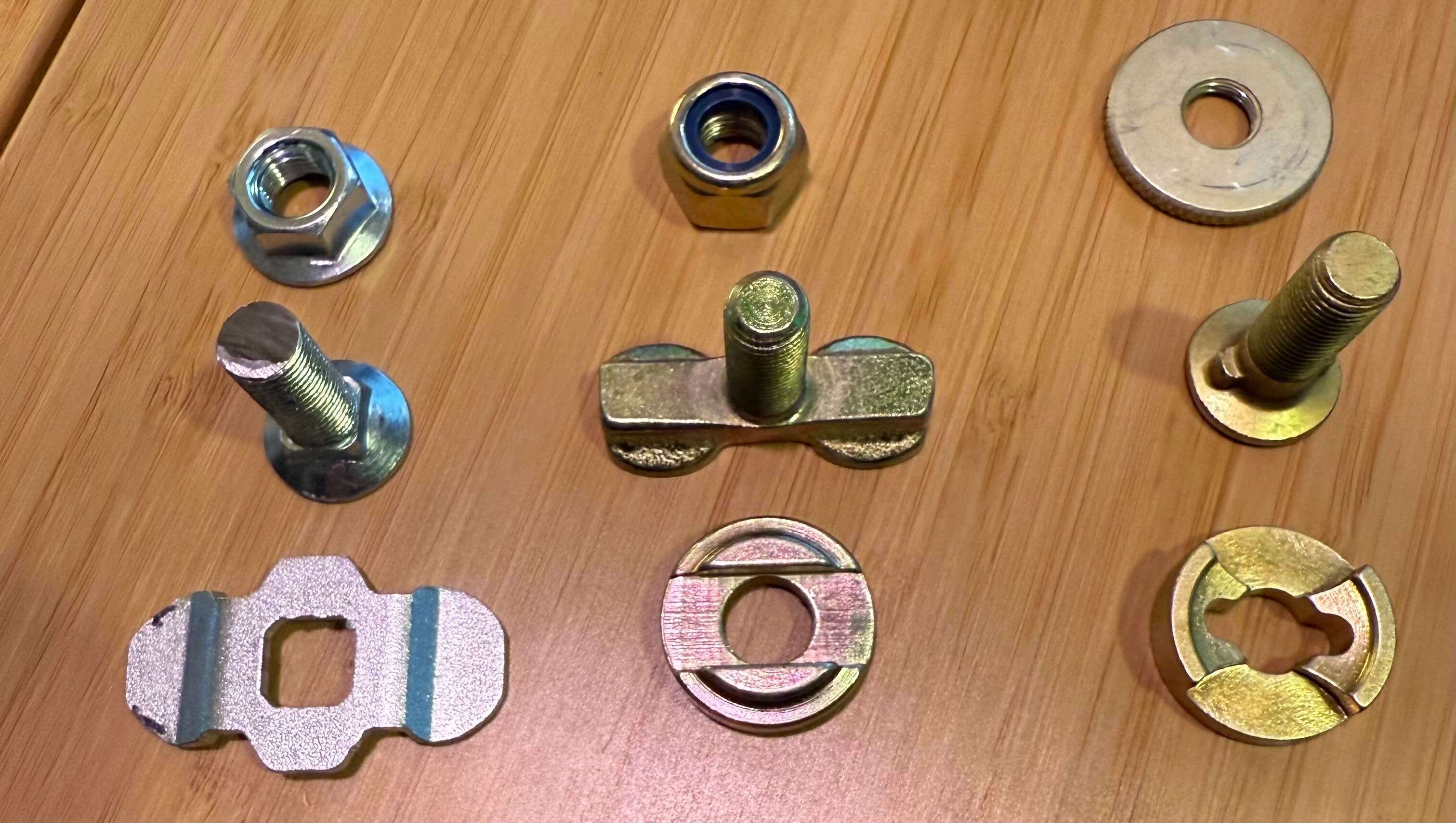

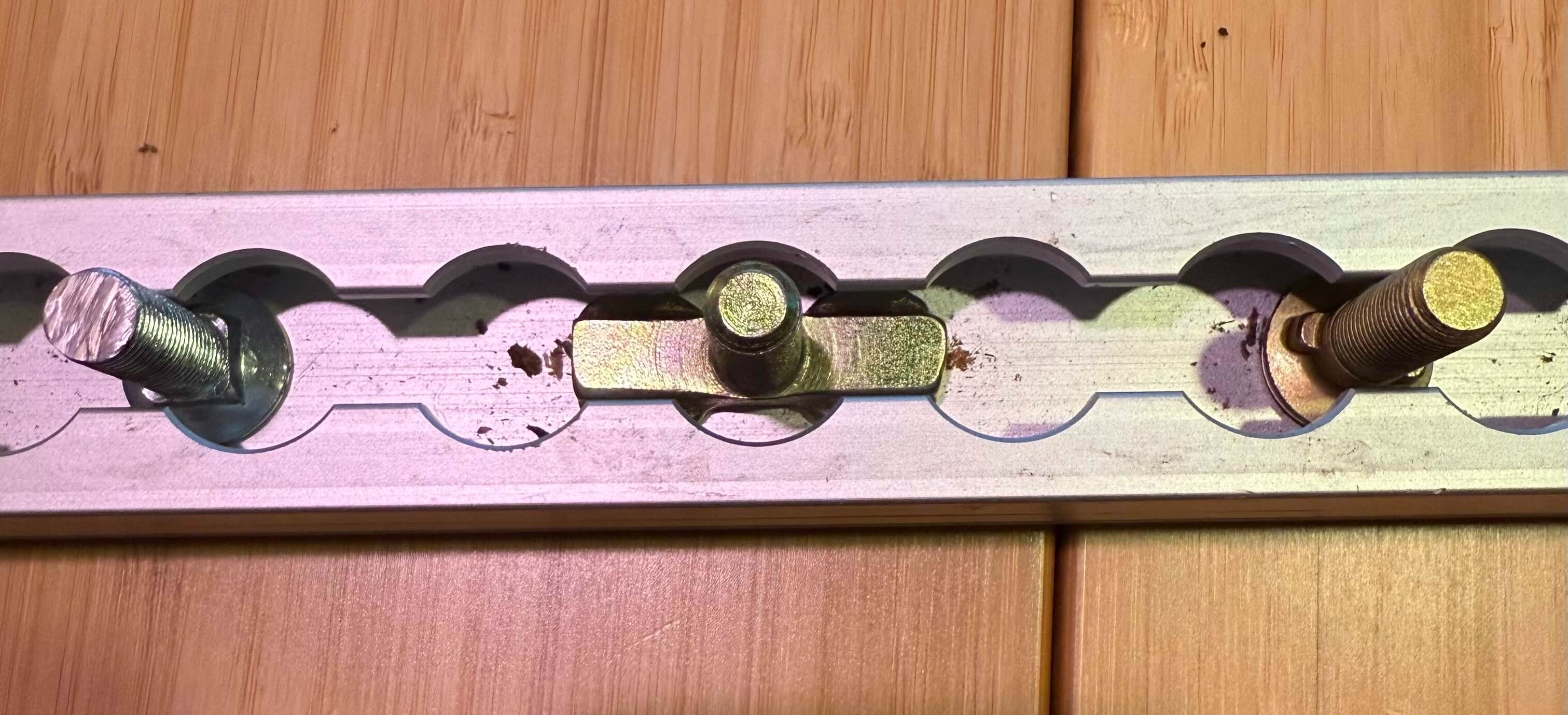

In the meantime, I ordered some L-track fittings and just got them in. I picked up a mix of options—from Amazon (budget-friendly), US Cargo Control, and one from McMaster Carr. (pricey!).
Check out Picture 1, 2 and 3—from left to right, you’ll see the Amazon fittings, US Cargo Control fitting, and McMaster Carr fitting.
• Amazon’s L-track fittings look a lot like the ones that came with the molle panel mounted in the rear of the Grenadier. They do the job, but I wasn’t super confident in them. So, I swapped them out with the US Cargo Control fittings, which feel much more secure—I’m really glad I made the switch!
• I especially love the US Cargo Control double lug threaded stud fitting since it seems to distribute stress more evenly across the L-track.
• The McMaster Carr fitting is also solid, but honestly, it’s just way too expensive for what it is.
Looking forward to testing the bracket out soon! Talk soon.
