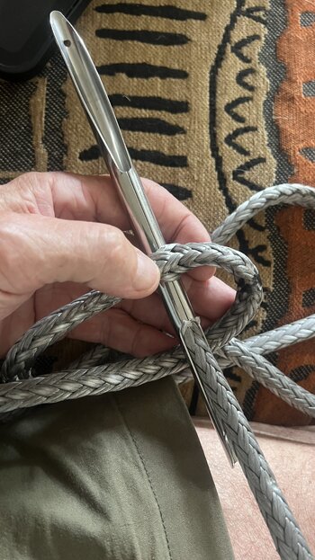

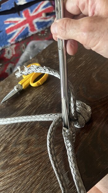

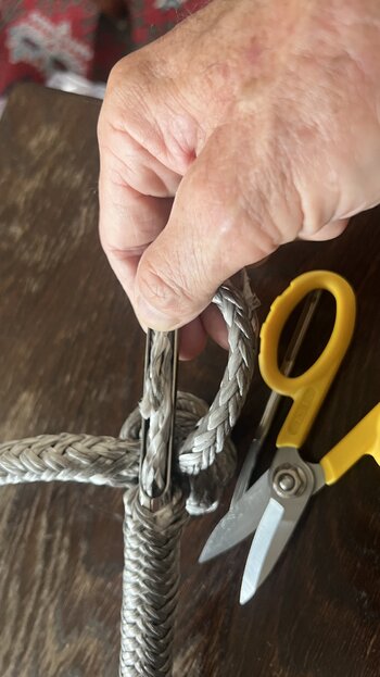

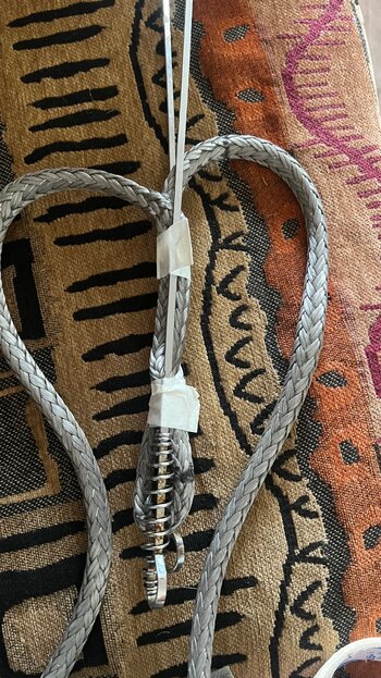

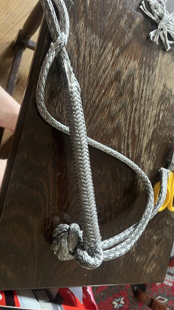

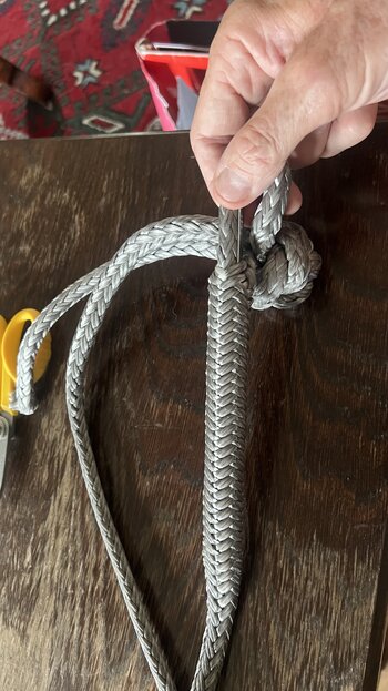

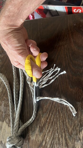

Those scissors are Miller KS 1. at £25 but any Kevlar scissors or fibre optic cable scisssors would do. And fidds are fidds I guess. A nice enjoyable hobby for me. Making up some soft shackles for mates also.Those kevlar shears are so great for this work, the dyneema just dulls razor and knife blades so fast.
The Factor 55 fast fid works pretty well too...

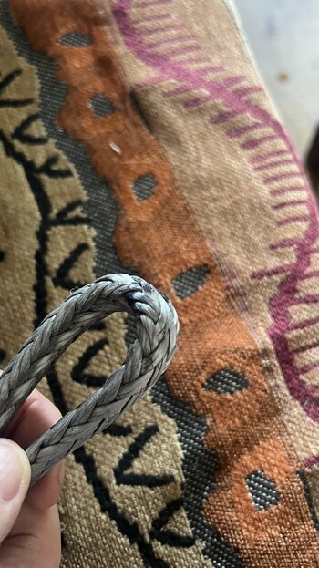

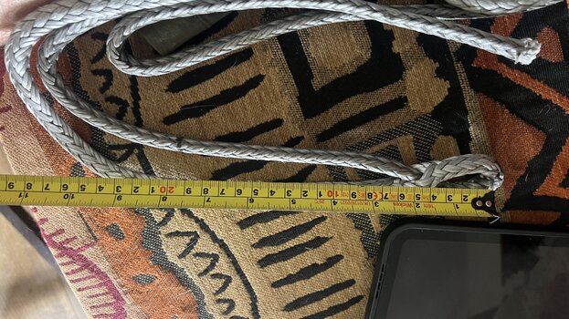

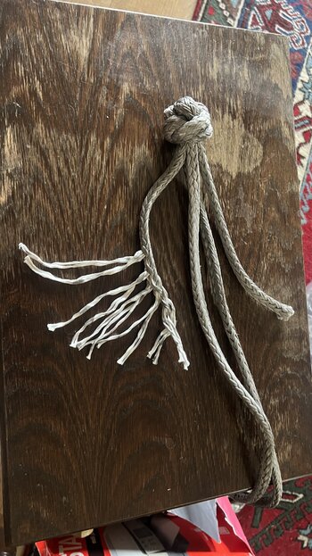

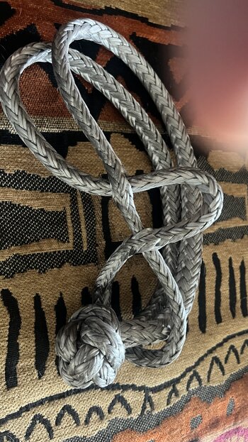

I'm not a pro, but I've taken a bunch of professional instruction. If purchasing recovery gear, it should always carry a tag that indicates the limits (MBS, WLL). Most of the no-name recovery gear doesn't have this label. Definitely not an area to cut corners.A bit of spare time on my hands. So I thought I would occupy my time whilst resting up. I’ve been making soft shackles up for myself and a mate. The light grey ones are 10mm sk75 dyneema and the dark grey ones are 9mm sk75 dyneema. The 10mm i purchased from a rope store and the 9mm I purchased a 30m winch rope from a 4x4 store. Upon undoing the winch rope and a soft shackle I bought to check one out, I found that the buried ends have not been tapered as they should be. This is potentially a weak point in the winch rope and the soft shackles. They were unbranded winch rope and shackle made in China I guess as most are. It just shows that with ready made ropes and shackles they are not always upto scratch. They are probably purchased cheap then a branded rope sleeve put on to suit a particular brand. Bearing in mind I’m talking about cheap brands not the well known professional 4x4 brands. I have full confidence in my own shackles, and button knots and will test some next week with a tractor.

Agreed. I purchased one without a safe working load to check it out and it confirmed my suspicions. I’ve been using my own for years and am confident in their quality. After all they are all tied by hand even the top quality ones and the art is in the button knots and how well and tight you tie them along with enough buried length and taper. If you don’t know how to make them then buy from a reputable source.I'm not a pro, but I've taken a bunch of professional instruction. If purchasing recovery gear, it should always carry a tag that indicates the limits (MBS, LL). Most of the no-name recovery gear doesn't have this label. Definitely not an area to cut corners.
