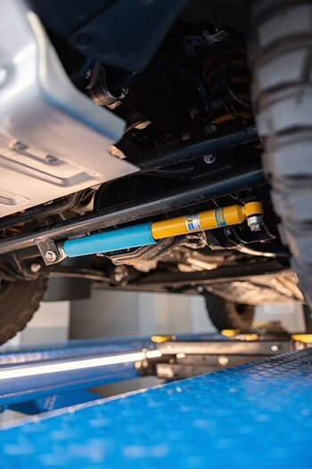

I just replaced my factory steering damper for the Bilstein one via GrenX. Bilstein Shock Absorber STEERING DAMPER – BE5 A580IG Stabiliser Ineos Grenadier - is the shop descriptor.
The driving difference is immediately obvious. The steering wheel around corners is self centering now. No longer push and pull. I was expecting a bit of a difference but this is a massive difference. The other benefits are 1. No more pushing the steering against that initial high resistance when turning from lock to lock, it is now effortless. And 2. straight line highway driving seems to require less course corrections (although haven’t done a long drive yet so this last item is a little subjective).
I suggested to my agent that they consider offering it as a dealer fit customer option ( ie factory style at no fee, and self centering steering as a paid option ). He’s gonna talk to Ineos Australia about it.
Haven’t tried it out on the rough stuff yet but will post after next time I go out somewhere a bit rugged.

Any bets on how long it takes for someone to post that theirs steers perfect from the factory and Sir Jim and the amazing engineers from Magna designed it perfect the first time and you shouldn't mess with perfection. 😂
Report back after a rough track experience.
I've said before , there should be different damping for city vs offroad drivers.

That's where the FOX ATS comes in. Fully adjustable. That said, I'm 100% ok without a damper off-road. I'm very much used to manual steering with no damper that can whip around and take off your whole arm.

Yup I'm here with that thought as well. I first couldn't find the sweet spot with my Fox and even thought about going back to OEM. However after making adjustments and driving between on and off road I can say I'm 100% happy with it now.

I considered this for a long time before I replaced mine and I came to the conclusion that the original came from a Unimog or heavy truck parts bin at Magna. 🤣

I set mine midway at 12 and it was perfect for me, getting my Trialmaster 90% of the way centered leaving 10% driver effort to honor the "intention" of the original.

In fairness, after a few days use the correction of self centring (or lack of) becomes completely natural and you don’t even notice. When I first bought mine I thought “yep, gonna need to try and fix this” - now it’s a complete non-issue.

Same for me. Have done 12,000 on the original version without issue got used to it pretty quickly. Switched to new self centering and still love it albeit slightly different now.

I drove a loaner for a week last month. Was immediately used to the stock setup. But it's still wrong. You can wear two different shoes and get used to them in a matter of minutes but it doesn't change the fact that one has a slightly taller sole than the other. The great thing is you can drive what you like. But be sure to warn people before they hop into your drivers seat. I let one of my employees drive the loaner and he almost ended up in a ditch first turn.

Thanks for this post, Dude! I will get just this steering stabilizer. I have not received my 2026 Trialmaster but i want to have it on hand when it gets here.
Yeah, I read about that also, but: when i went to test ride the car at the dealership i IMMEDIATELY noticed the issue with the steering...and that was in the dealership's parking lot. Steering was very hard to begin with, then i made a turn and noticed that the car kept turning unless i reversed the turning. It is definitely something that the car needs. There are a number of videos claiming the same thing.
Listen, don't mention the war. I mentioned it once, but I think I got away with it all right.
The OEM damper is fit for purpose for not driving in paved streets. I put the Fox damper on and it is significantly better, but still does not return to center completely. That is just fine with me and I enjoy driving the truck much more now. This is a cheap and easy fix if you want steering that more closely resembles power steering.
