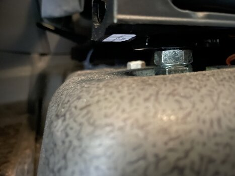

My solution: 2 nuts and a longer screw at the front of the rails.
