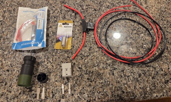

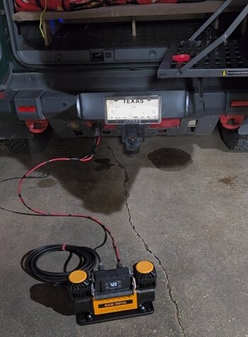

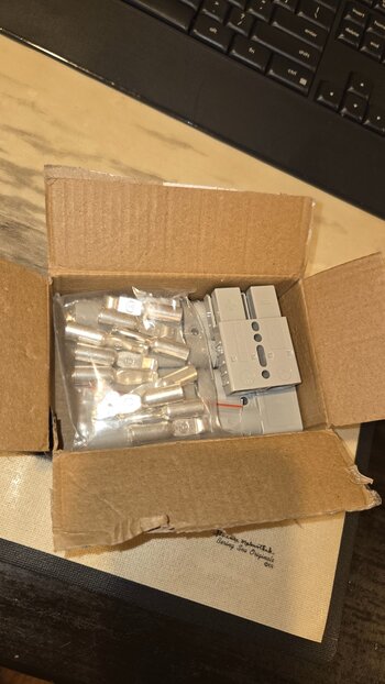

Inspired by others posting their versions, I assembled a NATO plug so I can run my compressor from the rear NATO plug without having to raise my hood. First issue was my compressor didn’t have a standard Anderson connector – more like ‘Anderson-type’ of plug. Found the odd ball Anderson size on Aliexpress (go figure on a budget dual compressor :) rated for 80 amp just like the OEM alligator clamp-to-Anderson that came with the compressor. Next challenge was finding a NATO plug that was under $100 USD! Holdmybeer on the forum pointed me to Eriks Military Surplus and Industrial supply where the new plug was sub $40 (thank you Mr. Beer). Shipping was steep and a bit of a wait for the mail but all in all I got it in hand sub $60. https://www.eriksmilitarysurplus.com/2pl24vo168am1.html Man those NATO plug pins are HUGE! Amazon got me a in-line fuse holder with two 40, 60, 80-amp fuses and picked up two 6-foot 6ga wire in red and black from Home Depot.

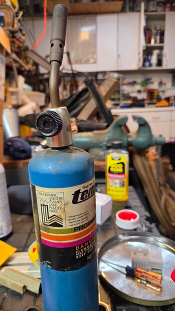

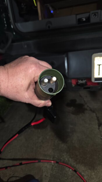

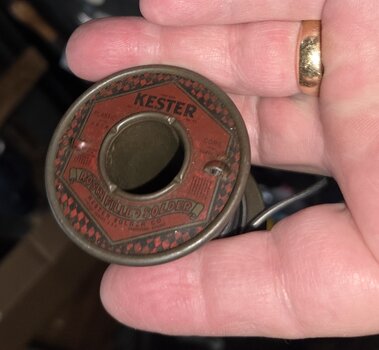

All the wire and pins were so big my soldering iron was useless. Dropped and broke my newish push button instant on Benzomatic mapp-gas torch in the late evening when I wanted to work on the cable. Had to bring out my wife’s grandfathers propane torch. I’m not one to get rid of duplicate or older tools and in this case, it paid off. Rocking a label touting the 1980 Lake Placid Olympics, the torch fired up just fine and I got everything assembled. Note – NATO pins were manufactured with small hole at the bottom of the pin bore. So, my idea of partially filling the pin with solder then heating it up and jamming in the cable worked but a LOT of solder came out that hole as I filled up the rest of the pin bore that had to be cleaned up. Next pin, hole was facing up. Used up all the solder in my kit (small boards and leads don’t take that much solder) since every pin and wire was so big. Scrounged around and found that same grand-father-in-law’s old solder roll. Finished up and it works well in home testing. Taking a long ride out to Palo Duro Canyon this weekend and I’ll give the cord a field test. I like the push-in / pull-out NATO plug I got, small raised dimple to hold plug tight, vs the screw on version because the dimple hold plus is very quick to put in and pull out. PS – the oil stains on the driveway are from my 2005 Tundra with 270k miles NOT my Grenny!
