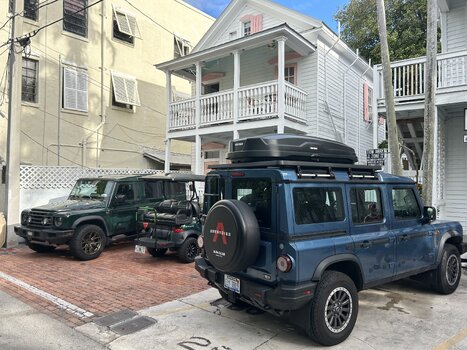

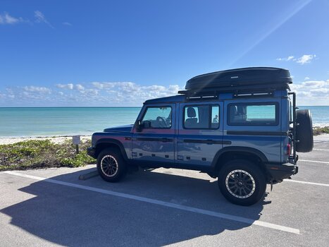

Recently installed Leitner's 3/4 roof rack along with Yakima NX XL cargo box. Does not interfere with safari window! Drove from No MI to FL Keys and very pleased with appearance as well as functionality. Very minimal wind noise which mostly occurs when coupled with high wind days. Ironically another IG pulled into neighboring villa in Key West as I have only seen 4 others in the wild during 2,600 miles of travel thus far.
