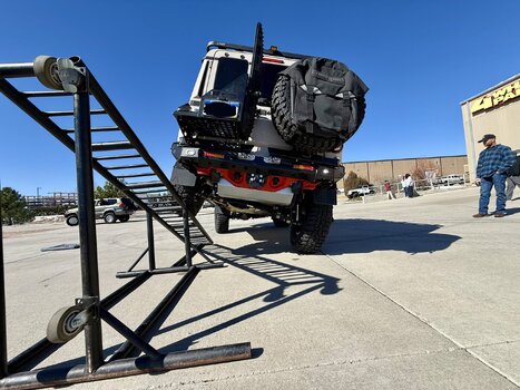

For those that have the LRA fuel tank, did you notice any reduction in clearance over obstacles?
Does it have a skid plate?
I use the metal cloak extra brace for the rear muffler skid plate. Is this compatible with the lra tank?
I'm basically trying to figure out if the lra tank is compatible with rock climbing?

I have the diesel tank but it's very similar below the mounts (the petrol tank is taller)
The LRA info says the skid is retained for the petrol aux tank - same as the diesel tank - so the departure clearance is unchanged.
The metalcloak bracket appears to occupy the same space above the skid as the LRA tank so I expect you cannot have both installed.
Plus one on clearance and factory skid still there.
Or after you bash your stock skid, just raw-dog it.😂
Seriously, those tanks are tough. I've put a few scratches in mine now and may Permabond some sort of HDPE to it. for a little extra glide over rocks.
