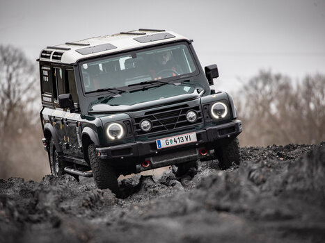

Alright then, need to get this off my chest (and I’ve seen similar sentiment in a few threads). I’m reserved for a Sela Green with white contrast roof here in the US (it looks too much like my favorite NAS Defender combo in Coniston green with white roof to pass up). I LOVE the red details on the prototype vehicles and noted as you all did that the recent change to the recovery points went from that brilliant red to some flat grey or black. I also REALLY love the red A on the small back door and on the bonnet lettering on the prototypes. What are our workarounds since I’m guessing we’re not getting any of this at this point?
The lettering on the bonnet and back small door can likely be wrapped or handpainted, yes?
The towhook recovery points can be powder coated to the same red I’m assuming, but my question is - IF those aren’t removable does anyone know if you can tape and powder coat something that is still attached?
All I know is that at some point I’ll have a Sela Green with white contrast roof in my garage and come hell or high water I WILL have those red highlights throughout!

The As on the hood and back door (and the spare tire cover too) will be easy. Someone will mock up the dimensions and cut vinyl to fit. Just like the decals used on pickups to “paint” the F150, Tacoma, etc stamped in tailgates.
I believe the recovery points are permanently attached to the frame so they cannot be powder coated since PC needs to be cured in an oven. I guess you could use red Raptor coating.

Hmmm…….not sure I knew how the powder coating process goes. I wonder if it can be taped/masked and just sprayed at a body shop? I know that wouldn’t be very durable though if you were actually using them as recovery points. I don’t see us using the points that much as we just plan on overlanding and rooftop tent camping.

Regular paint - even if applied by a body shop - wouldn’t look too good after a few uses. Raptor paint is like truck bed liner which is tough so that could do the job.

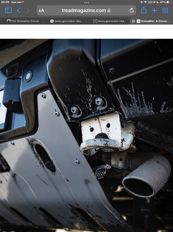

The rears very well might be bolted on. Looks like the fronts too. So @HouseMD it looks like you can remove and powder coat at a local body shop.

All the prototype photos I've seen suggest both have been welded on:
I'd like to know more about the front ones, and the reasoning why the attachment point is so far from the chassis leg and angled the way it is?

Good point. The front ones seem to face down too much. There will be a lot of strain on them especially if doing a snatch recovery even when using a bridle set up. Maybe they are designed to bend indicating they have been over stressed? But there again this would only make sense if they were bolted on and replaceable.
Are they rated does anybody know?

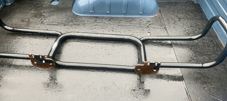

IMHO you are over thinking this in the extreme….
Just mask them off and paint the bloody things. Rustoleum make an awesome paint “Hard hat” industrial which is much better and goes on beautifully than their regular consumer product.
I get a lot of things powdercoated and my local guy (Trenton NJ) is about 1000 yards from my shop. But generally I prefer good quality paint as powdercoat can cause all sorts of other issues which are hidden in the long term. Rust sneaking underneath and destroying the metal. As per the pic of Defender brush guard. There are other areas on the welded joints where the steel is rotted right through with no external evidence.

I took it as though the torx heads were holding on the tow hooks but in reality it looks as though it’s the bumper mounts.
