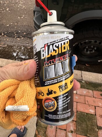

I noticed a couple of mine were sticking today (2024 vehicle but new to me). Quick squirt of lubricant in the lock and push the button a few times while open, and they now seem fine. New locks seem like overkill?
It’s a flaw. You shouldn’t have to spray the door handles on your brand new $90k vehicle with lubricant every 3 months. I get that works and I was doing that until an incident with my daughter. I shouldn’t have had to yell at a 6yr to hold onto the inside door handle from her booster seat to keep it closed til I could find a safe place to pull over., which was a problem because I didn’t become aware of this until I was entering a roundabout because the sensor was not showing it open and we couldn’t tel going 5mph in bumper to bumper school traffic until we got to the roundabout. I know enough to notice when the buttons were sticking but the 5th grade safety patrol at school doesn’t (funny enough, they get confused the by button all the time and try to just pull it without pressing the button weekly)
