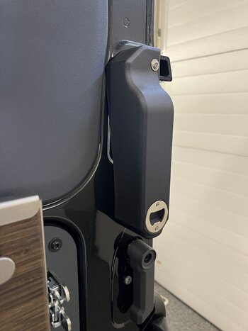

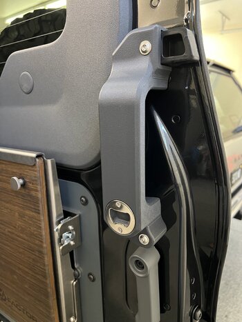

How well did the bed liner adhere to the plastic? I’ve been waiting for a brave member (read Guinea pig) to use bed liner on the cargo area plastics.
So far so good. It’s only been a week but no issues as far as I can tell. I sprayed 3 coats on all sides except for the side that fixes to the door. I left that side unpainted. I considered priming or roughing up the surface first, but it seemed like it had enough texture already so I sprayed it as is after wiping it down with isopropyl alcohol.
I like it. The added texture from the paint enhances the grip inside the handle. In the unlikely event it does chip or get damaged, its super easy to respray/touch up.
I used Rust-Oleum black truck bed liner. If I cared about color, and had more to spray than one relatively small part, I’d use Raptor Liner which comes in lots of color options and readily available on Amazon.
Installed my pull handle today very nice indeed. Well engineered, fit perfectly, matches interior well, solves an issue and above all else didn’t require paying the exorbitant “Grenadier Tax”. Well done @BenTN much appreciated!
