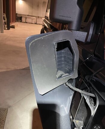

- In the new Rai, I added 2 mm adhesive foam to prevent it from rubbing against the bodywork. I'm attaching the first draft of how I prepared it.

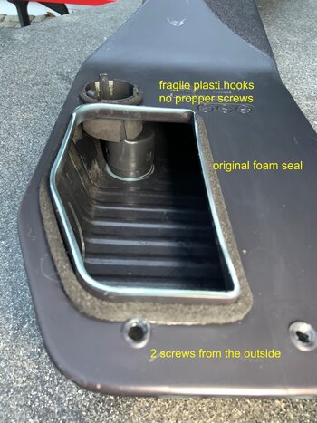

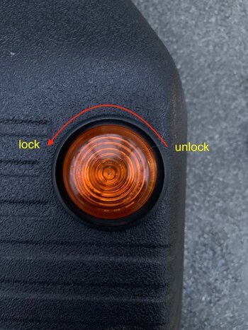

The first picture shows how to unlock the indicator. I always use instead water cheap silicone spray for this (€1.80 / 400g can). The problem with the RAI from Ineos is that it doesn't have a proper flange to connect the outer and inner housings and properly press the seal.
Instead, the outer housing is only pressed on at the bottom with two screws. At the top, it is only attached with the fragile hooks of the indicator. This isn't enough to press the foam seal firmly in place.
A Defender's BRAVO snorkel, for example, has several screws all around it to firmly screw the outer part to the inner part.

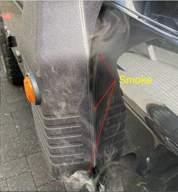

If you pull on the RAI, you can see how a gap opens up above the indicator between the housing and the body, through which dirt and, of course, water can get in. You can demonstrate this well with smoke.
