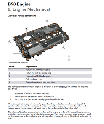

looking at the you tube video he makes a good case for oil catch cans. However he does say
that if you cut up the bmw part that separator is there. How ever what he call clean is what I
call dirty. Also you tube should be taken with a huge grain of salt. It is too expensive for me
to buy a part and then cut it up. Cheap to buy a oil catch can and will run it for 5,000 miles
and see what I get. This way I will have proof as to what is happening, see you in 5000 miles.
Will be finishing up the mounting bracket.
