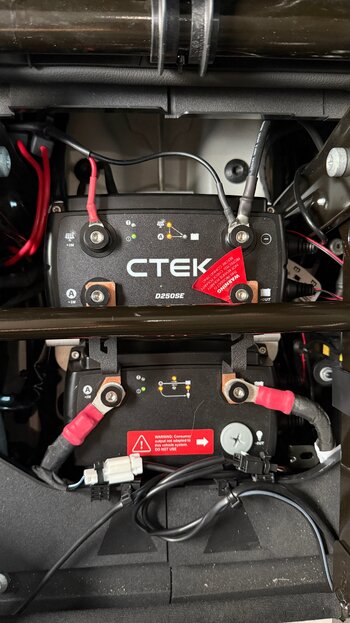

Hi everyone,
I’ve recently coupled a CTEK D250SE to my SmartPASS 120S, and I’ve mounted a 90 W Lensun solar panel on the hood, which is connected as prescribed in the manual, and I’m running the OEM dual batteries on my grenadier.

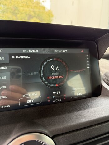

  • When I turn the ignition on On position without starting the vehicle, my off-road electrical screen doesn’t show that the system is charging.
  • The infotainment only shows a -9 A discharge, which I assume is due to my fridge running in the back at the same time.
My question is:
Should I be seeing the solar charge input on the off-road electrical screen on my infotainment when the vehicle ignition is OFF (engine not running) but on On position so that I can see if there is current pushed while the alternator is not involved in this process ?
Or does the system only show charging activity when the alternator is active?
I just want to confirm if this is normal behavior, or if the solar charge should appear on the screen even with the ignition off and only the solar feeding the batteries.
Or is there a wrong connection done that might be fixed and can give me a reading that the solar is feeding the batteries. I guess the reading in the infotainment reflects the total battery pool percentage and not only started? Correct me if my assumption is incorrect.

Put a cheap battery monitor on each battery and you will see the charge going in.
The charging shown on the IG Offroad screen does not show the solar panel putting in any charge, because the CTEK250SE charges the the aux battery, then the main battery (but that is not picked up by the IG sensor).
