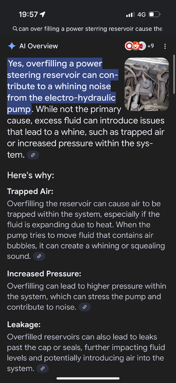

Alright folks, done some DIY research and been doing some tinkering. I have tried this as my power steering reservoir is over filled and there is excess weeping of oil. On the cap, there is a stalk with min and max. I’ve syringed out (or use a turkey baster) the excess fluid to under max on a level surface, when engine is cold, using a paper towel to wipe down in between each measurements.
I can definitely hear less noise and sometimes virtually no noise, which is a result. It also explains why some have it and some don’t. Just depends on whether there is trapped air present or if the coolant is over filled. You can only get an accurate measurement on a level surface and cold engine.
Someone please try it and let me know. Maybe we can put the whining power steering to bed.
Dealer said that level should be at "Min" for cold engine. Going to tinker around with varying levels to see if there is any change, assuming I can find some CHF 202 in Cape Town !!
Ok that sounds positive. Mine was well over max before. Now it’s in between min and max cold and the noise is a lot quieter. Let’s us know how it goes. You can buy Fuch Titan CHF 202 on Amazon (formerly pentosin).
AI answers can at times be misleading and incorrect. We have tried it at work and compared it to known correct info. Ask AI for sorce of the info and it can be an answer not expected, usually some media story.
A slight change in the question or statement gives different answers. "Overfilled power steering fluid can cause pump noise" gave a different answer.
