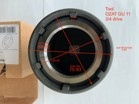

A special tool is needed for installing and removing these nuts, such as the
OZAT GU 11 3/4 inch drive
or the
Fermec ST 55 GU 3/4 inch drive.
When purchasing, ensure the tool has 6 teeth. The inner diameter of the tool should be approximately 75 mm, and the outer diameter not significantly larger than 85 mm, otherwise it won't fit into the wheel hub.
There are other DIN standards for these nuts, but either the outer diameter or the thread pitch of these standards doesn't match the nuts used by INEOS/Carraro.
The silver DIN nut in my pictures is for reference only. While it does fit the rear wheel hub of the INEOS, it wouldn't be possible to properly secure it.
You could compare your tool with the measurements of my tool.
Thanks. Mine measures up exactly. It's also stamped 2-GU11.
