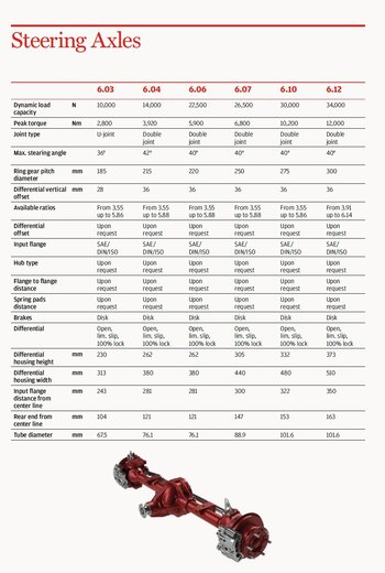

Since the INEOS Grenadier uses the Carraro HS6.04 axle at the front and the HS8.06 at the rear, it seemed likely that this nut also came from Carraro.
That's indeed the case, and the nut is listed by Carraro under part number 135938. As a Carraro nut, it costs only £30 or €35 on eBay, for example.
I received two of these Carraro nuts with part number 135938 today. They are identical in all dimensions to the nut that- Logsplitter- received from INEOS.
