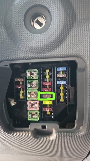

I had this some time ago together with an e-call failure and a stuck gps (Pathfinder). It worked again after reset of the 5A-circuit breaker in the middle of the CB- stack below the key
