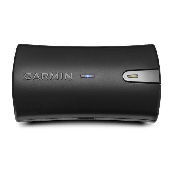

I have an extra Garmin extern gps receiver as a backup when the cellphone coverage is getting poor. It gets navigation more precise and faster.
GPS isn’t dependent on Cellphone coverage, although maps may be if you dont have them downloaded. But if I understand your device properly it also won’t help if you don’t have maps downloaded other than giving you coordinates you could check on a paper map
GPS is assisted on iPhones by cell tower triangulation. But yes, pure GPS devices don’t need any cellular connection. They even get date & time info from the satellites. And most devices (eg Garmin wearables) are both GPS and GLONASS.
