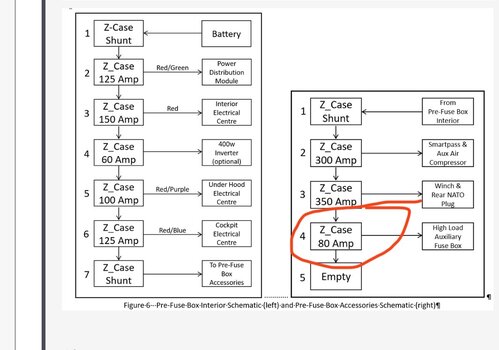

You'll find that the high amp pre-fuse busbars are under the rear passenger seat, not in the engine bay. To start with I would look at the 80amp z case battery fuse in position 4 on the 5 stud Accessories pre-fuse box.
Further details below:

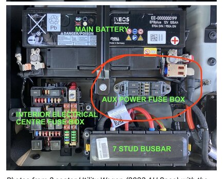

I used a multi meter and there is power at this z case 80 amp. But not at this Aux fuse box.?
That's a bit of a head scratcher for me but at least you've narrowed it down. Faulty Aux Fuse box assembly????
The following is the fuse and relay schematic for the Aux fuse box.
Did you measure on both sides of the fuse?
This would be the fuse I would chase down. There should be nothing between it and the downstream fuse box for each circuit.
