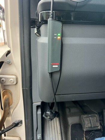

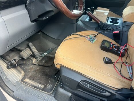

Hi everyone,
I’m looking to connect with people who have serious, hands-on expertise in working with the OBD2/OBDII port and CAN bus systems on the Grenadier.
To be clear — I’m not looking for guesses, assumptions, or general advice. I’m specifically interested in individuals who actively work at a technical level with these systems.
I’ve just started exploring the OBD2 port of the vehicle today, and within about two hours I was already able to establish communication with four different ECUs via the standard CAN bus through the OBD2 port.
This was done without any deep reverse engineering so far — that’s something I plan to dive into next.
So there’s clearly more potential here, and I’d be very interested in exchanging knowledge with others who are operating at a similar level.
If you have real experience in this area and are open to discussing or collaborating, feel free to reach out via PM and name at least three Grenadier ECU's with their CAN bus IDs via PM - then we can talk. ;)

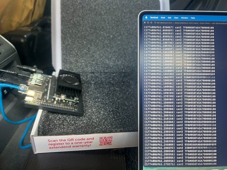

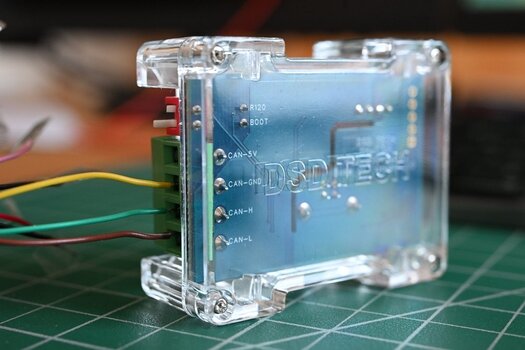

I'm just using some standard CAN-Bus hardware and all coding is done in Python for now. This way it's easier for prototyping, easy to change and fast turn around cycles.
One hardware I have is an OBD2 pigtail cable and a DSD TECH SH-C31G USB-to-CAN adapter, all from Amazon. This is the cheap low cost variant (50 Euro), but you have to assemble everything.
And my other preferred solution is a turnkey adapter USB-to-OBD2, it's more a professional automotive grade device, a pretty expensive Kvaser Leaf v3 OBD-II (350 Euro).
The hardware is just a small part, most of the work is to craft the software...
And I'm using a dedicated Linux device in the vehicle to do all tests live even while driving the car. A NVIDIA Jetson Orin Nano development board.
But here the major work was to get the Linux kernel drivers for the above OBD2 CAN interfaces running...
