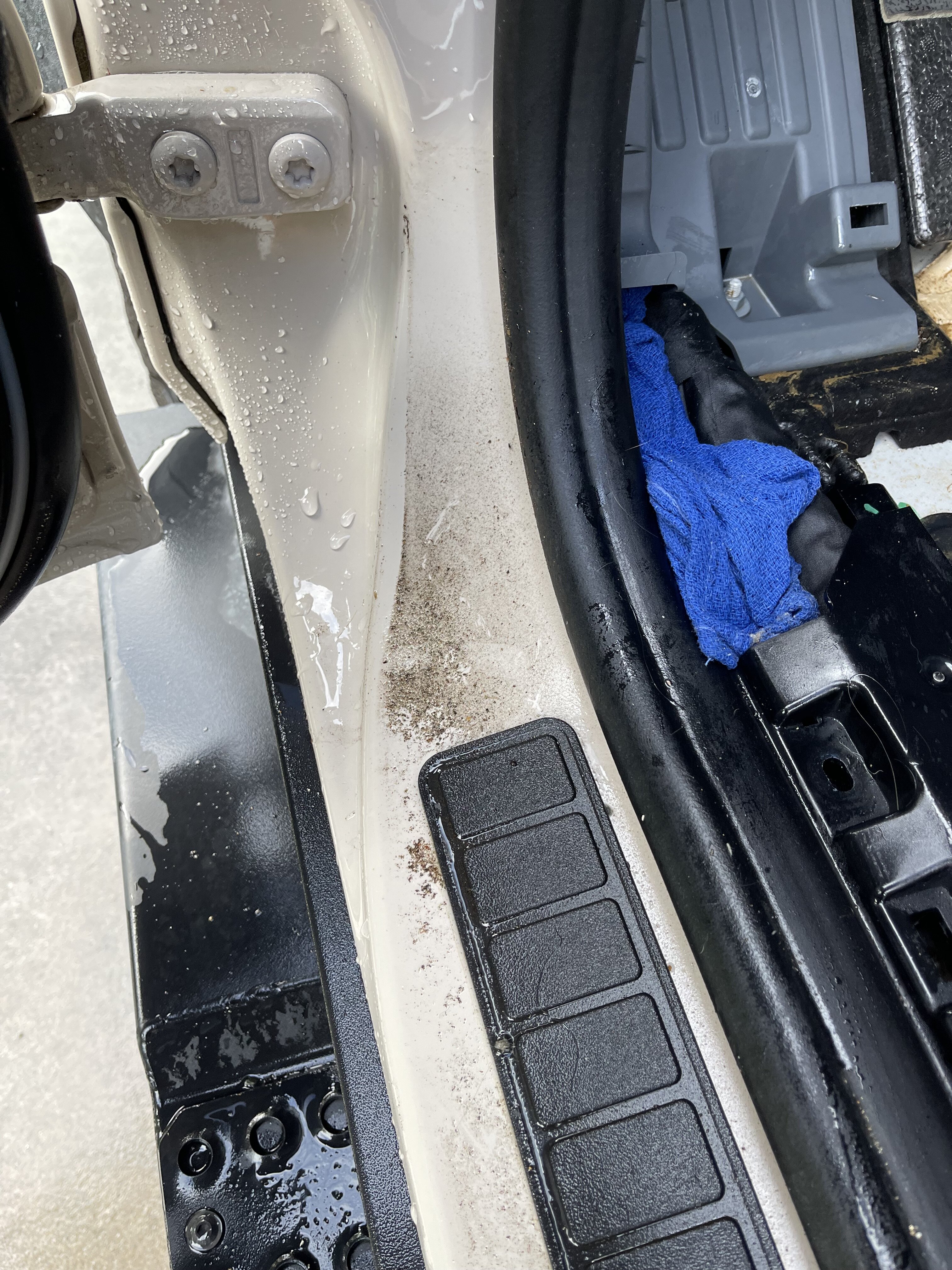

HEAVY rain here last night and we now have water ingressing to the footwell area and Pooling around wiring looms etc… 🙄
Anyone else have this level of water intrusion?
I noticed that when attempting to remove the trim around the bonnet/hood release there seemed to be a new release of water. I’m wondering if I have water getting in elsewhere 🤦‍♂️🤷🏼‍♂️

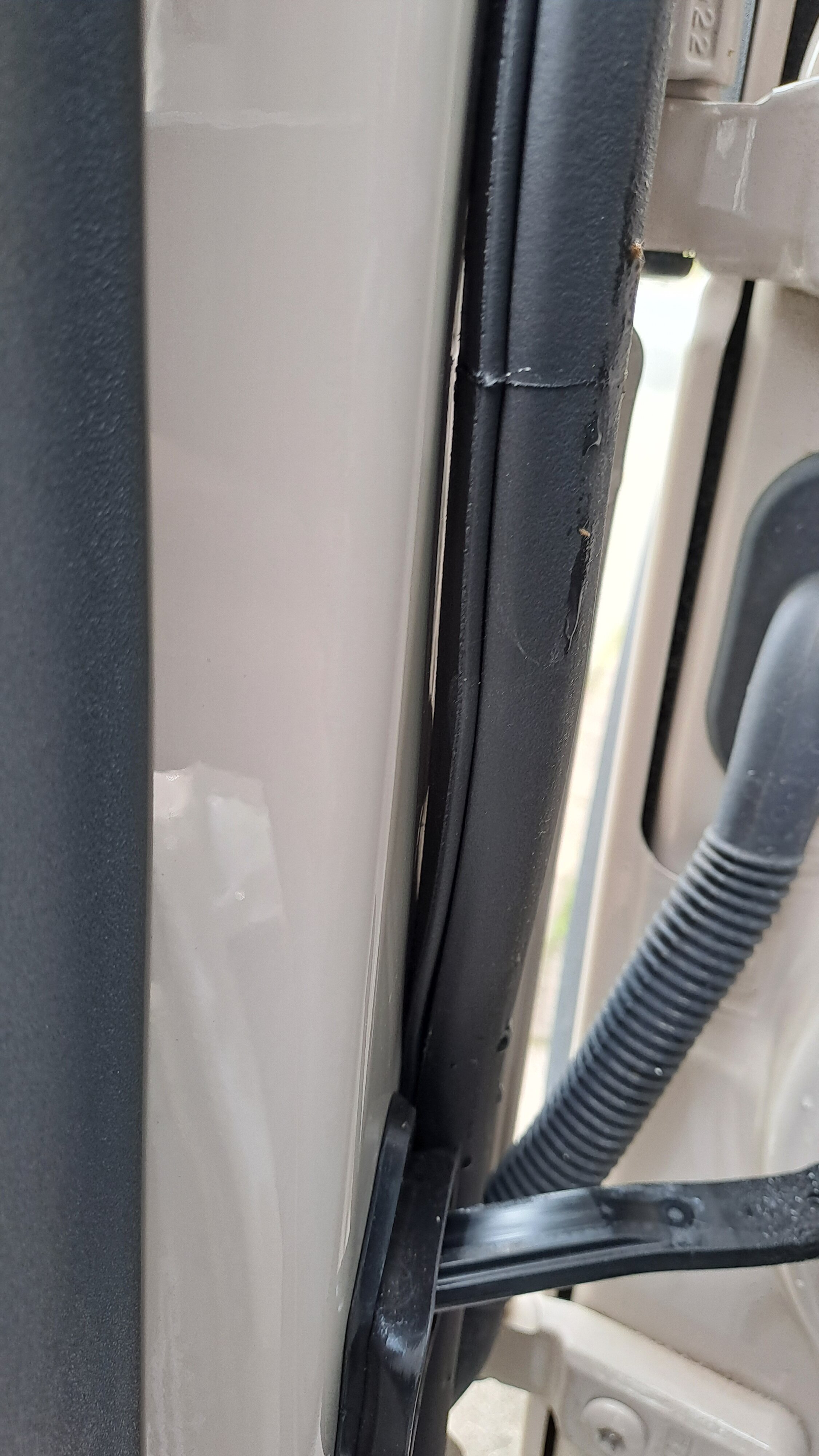

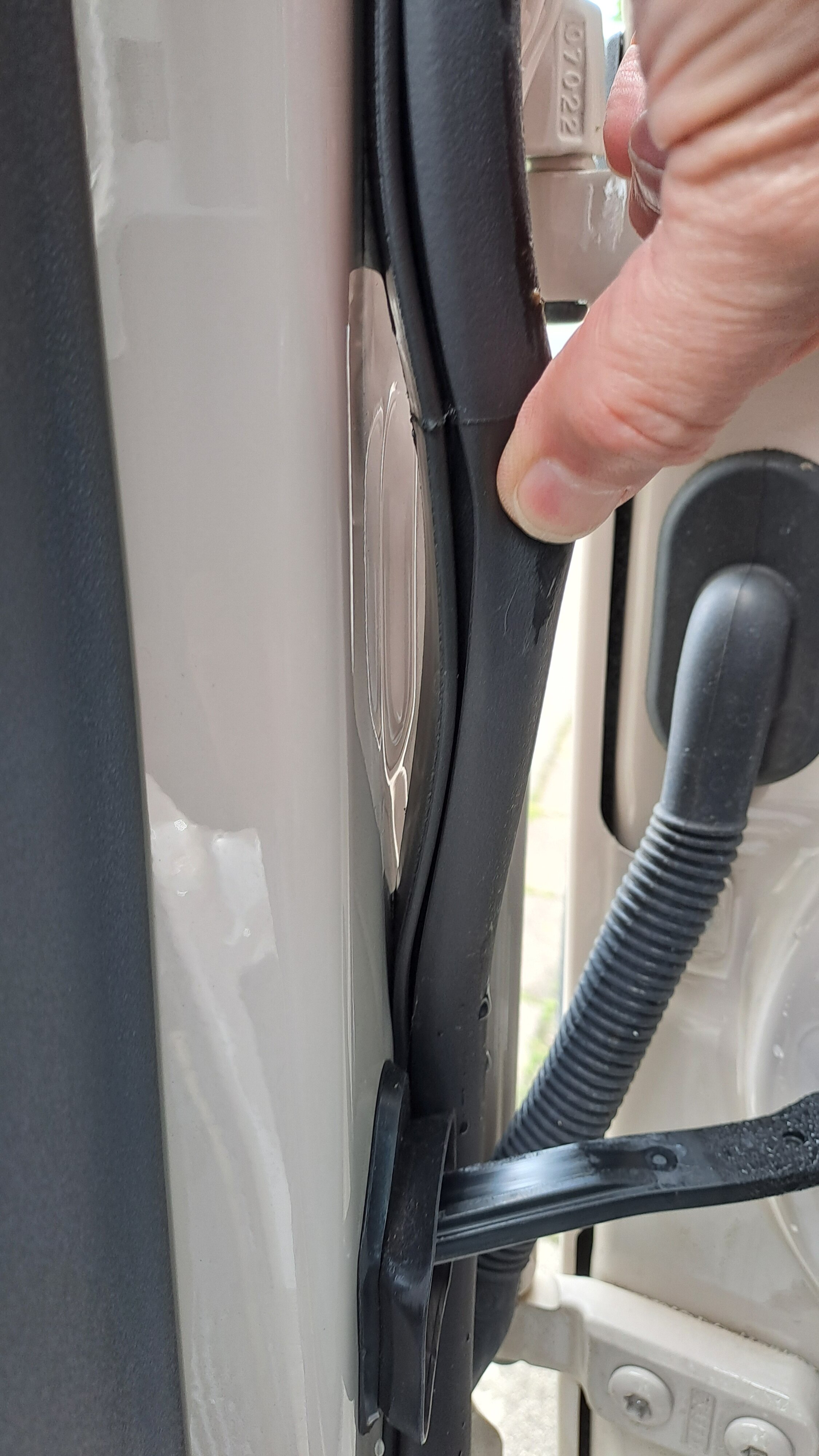

Heavy rain yesterday and wet feet. Surprisingly, this is a new "feature". 🙄
I hope that the loose rubber seal is the only cause. 🤷‍♂️

Simple answer is yes with heavy rain.
Mine filled up the gap between the inner and outer sills which then overflowed into the cabin. A layer of water across the whole floor.

I can say from experience that it is only due to the loose seal. I had it once last summer. I looked at the seal and some parts of them were no longer glued on. I fixed them with 3M Power Tape. Nothing has happened since then. The punching out that INEOS and the dealers do does not eliminate the cause. That's why I specifically told my dealer not to follow INEOS' instructions and cut out the seal. Then I'll get uncomfortable.
I have not had the water pooling but I decided to check my door seals anyway, and found all four had gaps behind the door check straps. Three of the four pushed back in place and the adhesive appears to hold, passenger door it will not stick. I'll add all door seals to the next dealer visit list.
