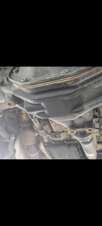

Woke up this morning to find oil on the ground. Looks like a seals gone ?
it looks like there is misting around the diff as well, might be the same oil traveling laterally - or I fear there is another leak :/
Is that the diff leaking? Or the end of the axle (called swivel housing, as well?)?

I will need to get under the car when i get home later today, but there is definitely oil along the tyre and in the middle of the axle

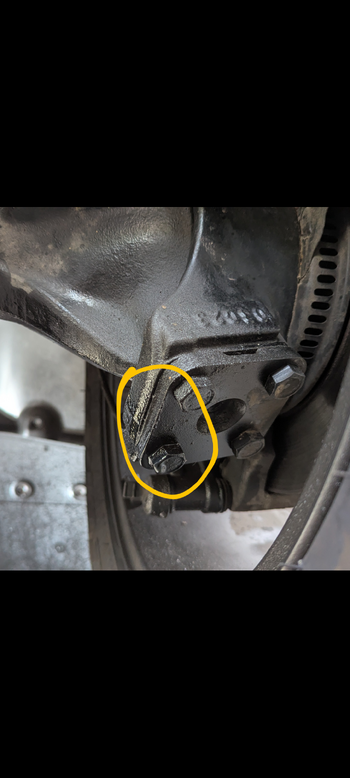

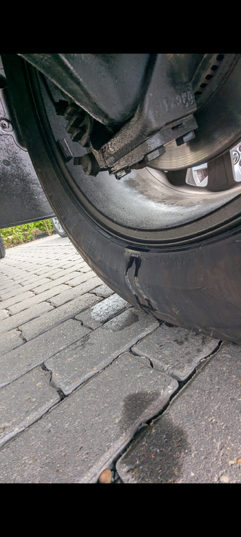

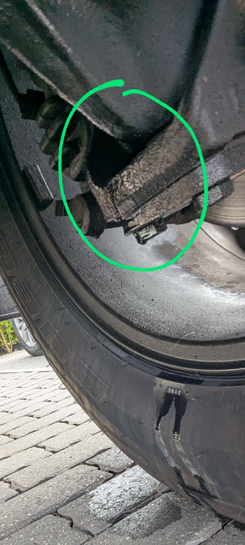

Oil is dripping from the nut highlighted in yellow... But the entire area around and above it is super oil saturated, highlighted in green.
It's interesting to note that the entire plate is not square with the housing it's attached to! Clearly visible on the pic with the yellow mark.
Looks like the lower king pin has shifted. Maybe loose. It could be an optical illusion but is that shiny metal on the part I indicated in red.
I think that's just light reflecting off. But I will get a picture square off the side once it stops raining.
