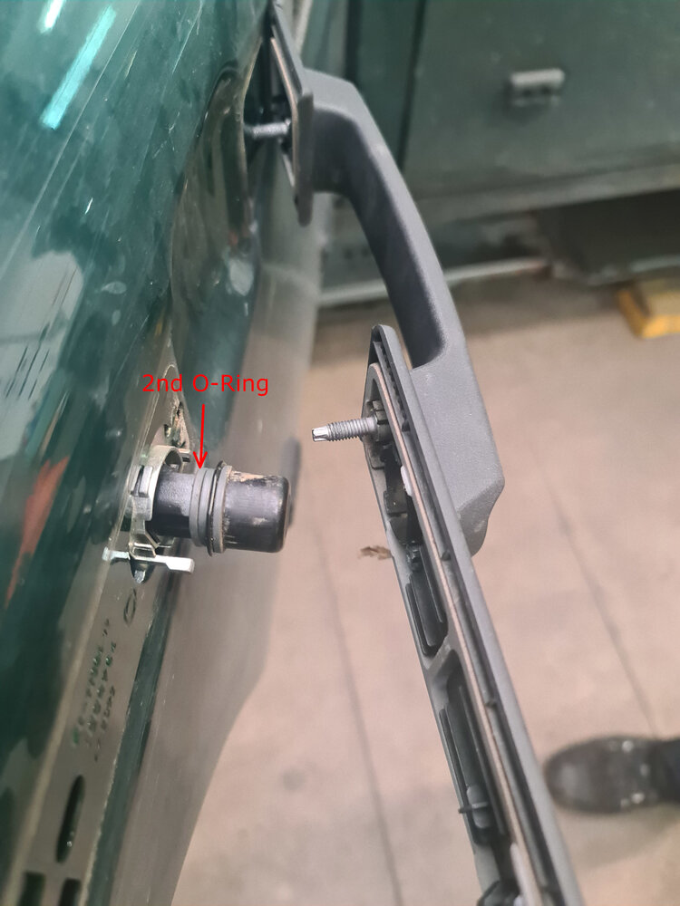

Did this solve the stickey door button issue?Wednesday they executed one of the recall actions on my car: door knobs got sometimes stuck. I was allowed to watch the last one to be "repaired". Quite some dismounting needed (see first picture) and what they did was placing a second o-ring in the knob. This was already mentioned in another thread, but I am not sure if somebody made a picture.
View attachment 7828873View attachment 7828874
I doubt that this will solve the problem completely, but we will see.
You will notice the nice scratches, from branches, not vandalism, well, my own vandalism.

No, one knob got stuck again during some days, and although I didn't do anything I "solved itself".Did this solve the stickey door button issue?

Is this the same solution on current recall for handles? Taken a while to filter through from ineos.Wednesday they executed one of the recall actions on my car: door knobs got sometimes stuck. I was allowed to watch the last one to be "repaired". Quite some dismounting needed (see first picture) and what they did was placing a second o-ring in the knob. This was already mentioned in another thread, but I am not sure if somebody made a picture.
The current campaign is to replace the entire button mechanism on all doors (5). The ignition barrel also gets replaced and two new keys are supplied.Is this the same solution on current recall for handles? Taken a while to filter through from ineos.
