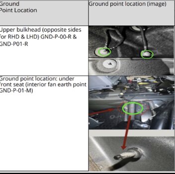

The dealer went full deep-dive and traced every wire. Turns out one of my ground straps, one unrelated to the A/C, wasn’t connected properly. Once that was corrected, the A/C started working exactly as it should. It was the ground strap under the seat and under the flooring.
So if you’re dealing with the same A/C symptoms and haven’t gotten a real fix yet, it might be worth having the ground straps checked before throwing more parts at it.
Hope this saves someone some time and frustration. Still love my Greeny despite this hiccup. Crossposted on other platforms so sorry if you have seen this already.
TL;DR: have the dealer check the ground straps, even those unrelated to the AC system. What fixed mine was the the ground point under the driver seat. It is a 10 mm bolt located under the flooring near the center console.
