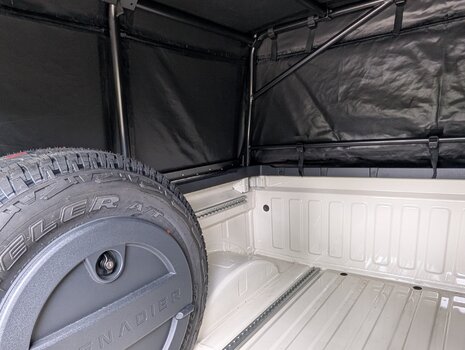

l track: have it on the bed and on the side. The dealer installed it for me. Used it today to pick up my wife's electric cargo bike. Needed to put the bike sideways to fit. The bicycle is basically 70 inches.

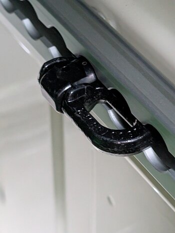

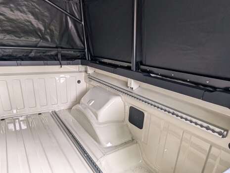

Here you go and I included what I use for the L track, 5500 break point.
You're a scholar and a gentleman. Thank you.
Heck, I can pick up that O-track from my local hardware store. They have plenty of tie-down options, too. Looks to be the same as what I installed in my moto trailer.
On your bed rails track, it looks like you added additional mounting holes at the ends. Was that done by you or is INEOS selling tracks pre-drilled with the extra holes?
Those were already in the bed when I picked up my QM. Yours should have them too. The L track came from dealer and I believe it is pre drilled for the Grenadier. Someone else added L track and had to drill to make it work.

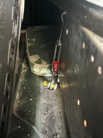

M8 bolts 25mm in length. No Lock tight yet, as just trying out the system I have set up. Good to use though, and will once sorted. First pic shows original tie down point. second is in the bolt at the front of the drawer set up. You can see where the holes are by the black dots in the first pic.

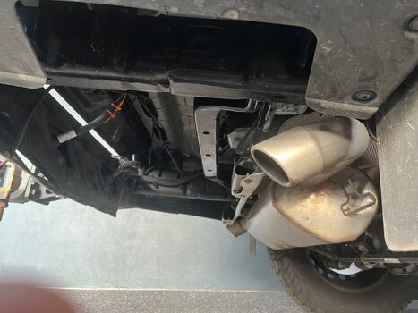

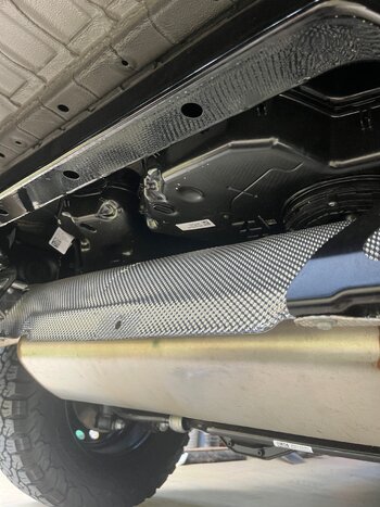

There is space under the bed for a tyre to tuck up. Probably need to remove the muffler. No Ad Blue on the petrol version, but mine has a flat 17l tank tucked up under the bed. You can see chain spare wheel lifts on line that might work. The picture shows a bit of the room under and looking at the muffler which is in the same location as on the wagon version. Ad Blue tank above
Placing a tyre there will affect the departure angle, as you can see the low point to the left where the tow hitch is attached. Maybe hang down an other 100mm. At the front, standard tyres will not hang down more than the muffler placement.
